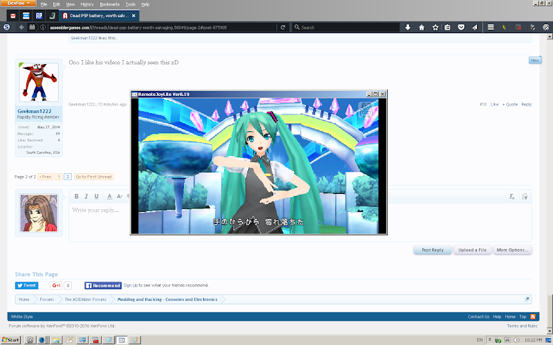

    3,879
    245
    A broken PSP can still be used this way: (lol)
    That one has bad UMD circuitry and bad screen.
