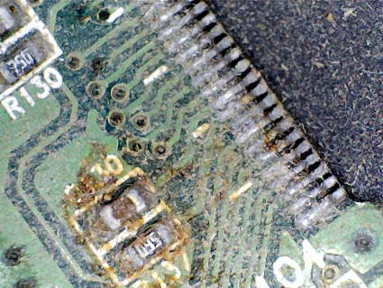

    clock capacitor leaked?

    Thats a possible cause.
    Crack it open and take a look

    - AC input connector has loose solder connection with the board. That is probably not the case here as it will give you warning signs in the form cracking noises when you connect or wiggle the AC cord. You would have noticed something was amiss.
    -The traces connecting the soft power/ejects buttons got corroded. This usually results in a erratic on/off behavior, but i can see a console simply not turning on.
    In any case good luck!

    Caps, PSU, powercable, just check the inside for corosion, burn, lose parts.
    blown cap: http://www.atariage.com/forums/topi...-xbox-1-moddingpcb-repairhdd-upgrade-service/
    I dont mean the service, look at the pictures :p dont know him, just googled for examples.
    And this is also corrupting data, clean it and maybe it will work again :D
    Good luck :D also post pictures if unsure ;)

    I picked up a Xbox a few months back that had trace corrosion. This caused my console to never power off unless i unplugged it. Checked out this post and found a few traces were screwed.
    Id try this before scrapping it.
    http://forums.llamma.com/viewtopic.php?t=12329
