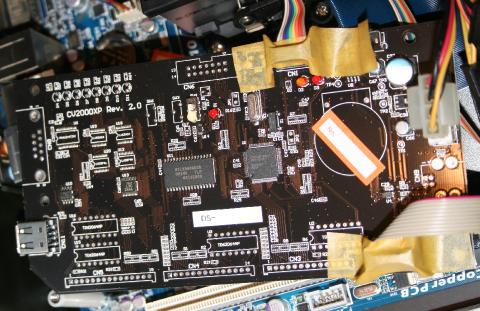

    Does anyone has picture of its JVS interface?
    What I know about that is it uses Direct3D 9 and XAudio, has an USB to serial convertor known to its XPE OS as COM3 and COM4.
    Its dongle is just a standard USB flash drive without any special drivers.

    I just sent one out for repair but it is a custom sub board that connect to a USB header.

    With a Renesas USB to serial chip if my analysis was correct.

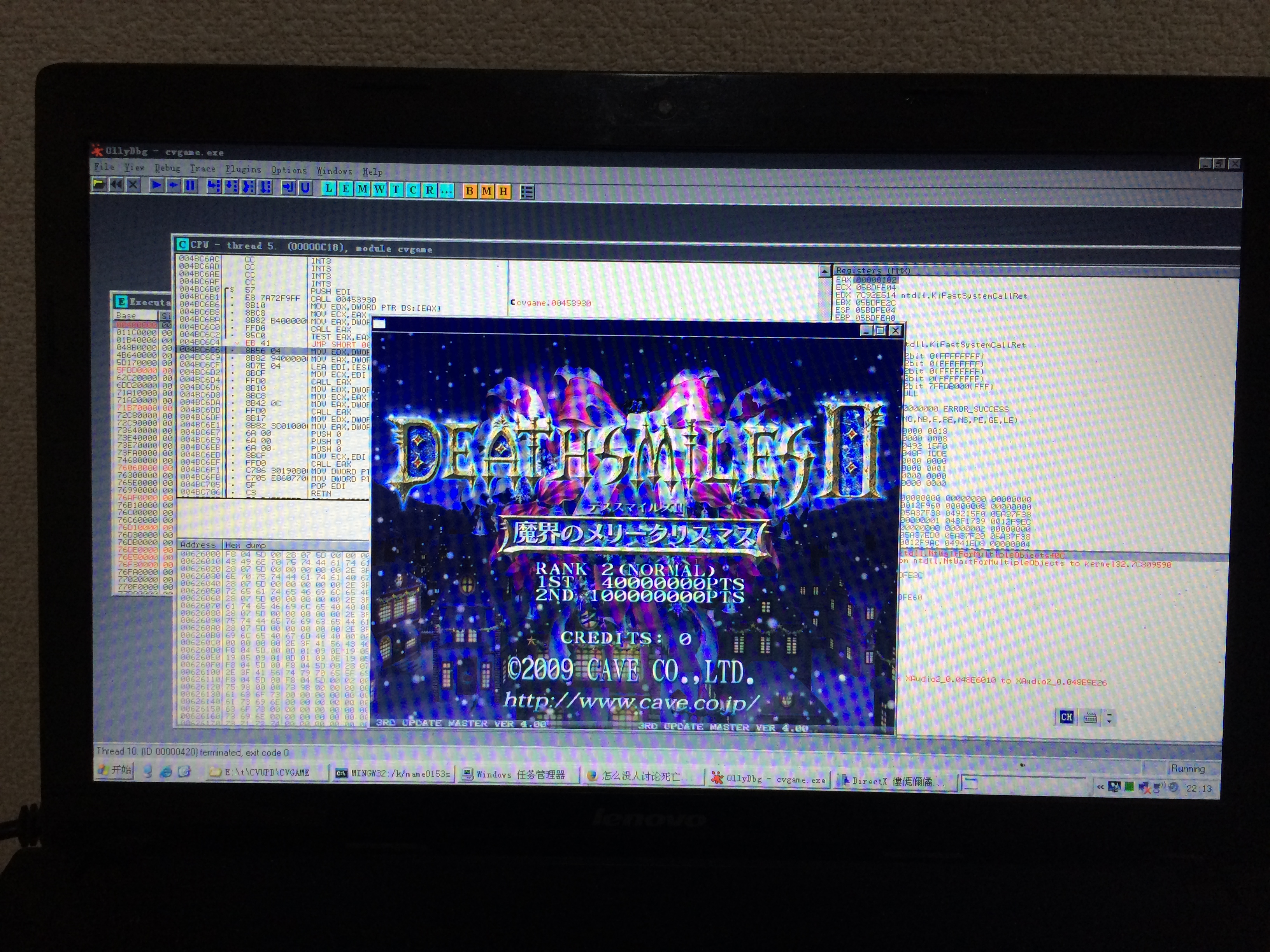

    Someone with a Type X system already tried this but the game hangs with a JVS error 4003. Cave must used some custom protocol in their JVS board, and as no save files are found anywhere in CF card and USB key it might even store hi-score data within IO board.

    here is it
    on logic level it is "JVS Host": as COM3 it have custom commands input, and output standard JVS commands to (standard) JVS board.

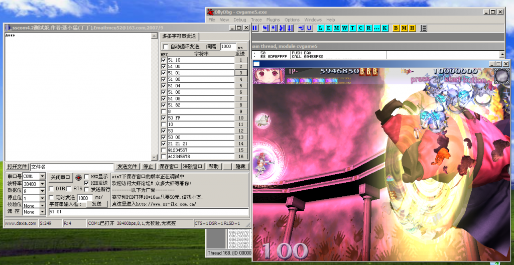

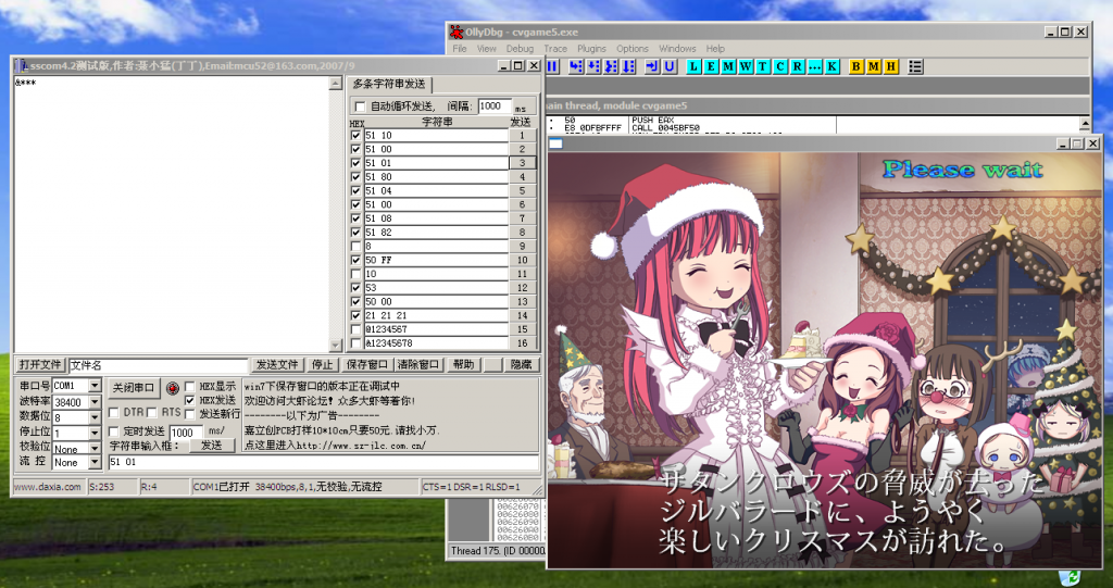

    The game sends packet 40 2A 2A 2A and 26 2A 2A 2A to COM3 (38400 bps) on cvgame.exe start. If no response there will be a JVS error 4003.
  11. yksoft
    yksoft Member
    Jul 15, 2014
    18
    The response to the first packet is "@***", The second response should be "&[8 digit number]" and the number was used in the calculation about USB Key CVKEY files, so it might be a unique ID for each IO board and USB key pair. A JVS emulator won't be that easy to make, since the protocol might use data from USB key as encryption key. An in-memory hook for its input routines might be a better solution.
    In-game JVS errors
    4001 Serial port not found, or wrong data read from serial port
    4003 Initial handshake with serial port failed
    4004 ???
    4006 ???
    EDIT: The serial input packages are of at least 5 types, starting with ASCII 'P', 'S', 'Q', 'R' and '!'.
    Command "!!!" should be a heartbeat signal and is detected by the game every 6 seconds.
    Command 'S' inserts coin.
    1p
    51 00 no key
    51 80 start
    51 01 button 1
    51 02 button 2
    51 04 right
    51 08 left
    51 10 down
    51 20 up
    51 40 service
    2p
    52 00 no key
    52 80 start
    52 01 button 1
    52 02 button 2
    52 04 right
    52 08 left
    52 10 down
    52 20 up
    52 40 service
    50 00 test switch up
    50 FF test switch down

    I already made a loader by forking Romhack's EX-board xb_loader. However it's not allowed to discuss such things here I think.
