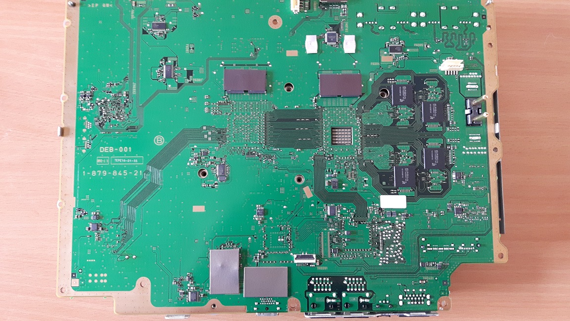

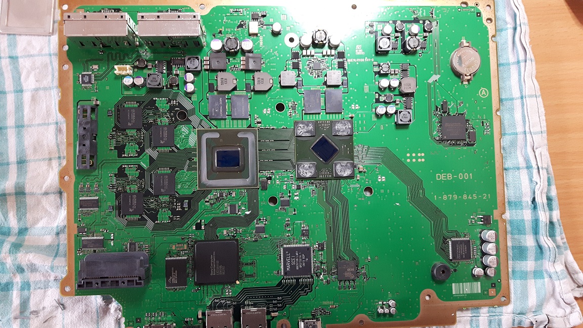

    Here are some pictures of the DEB-001 motherboard from a german forum:
    I get a DECR 1400A next week so I can take some high quality shots from the motherboard for psdevwiki.

    182
    That would be nice, we are lacking high high resolution pictures and it would further help identify the components
