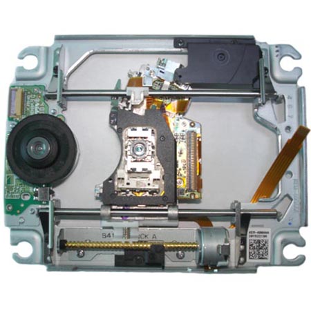

    Normally yes, inside DECR1000A, the whole drive is a KEM-400AAA, so the laser reference is KES-400AAA (KES = laser only, KEM = deck + laser) :)
    Open your bddrive, and check the sticker (like this pic), the KEM reference is writed on it ;)[​IMG]

    I second that. my DECR also only read disks when it wanted to, and if it worked it stopped reading after a few minutes, I had an old CECHA01 lying around and I swapped the laser system (I swapped exactly what is in @Pad17's picture) and it worked again, It can now read Blu-rays discs .and data DVD's

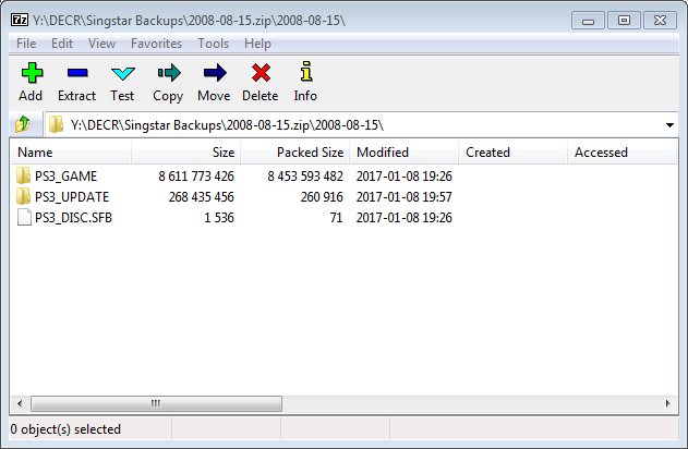

    Bumping an old thread but does this look like a correct dump?
    I also tried replacing my DECR drive with one from a different kit but that one wouldn't take discs, probably broken :(. Mine hasn't acted up yet so I'm going to leave it as-is until it breaks.

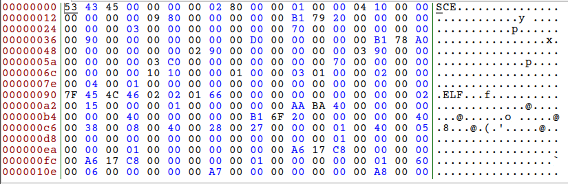

    open the eboot.bin in a hex editor and post a picture. ill tell you if its correct

    Thanks for verifying! I'll upload them soon and post them (I think I saw a thread for dumps already?)
