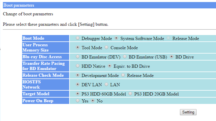

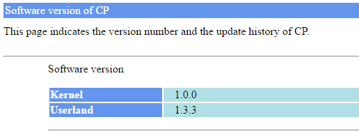

    First of all, what's your CP version?
    This is mine
    And second of all, how does your boot parameters look like ?
    Did you try to boot to system software mode?
    It's either RSX faulty, or HDMI setting issue could be caused by boot parameters or HDD not being detected which can be fixed after formatting on PC and reformat on recovery mode.
