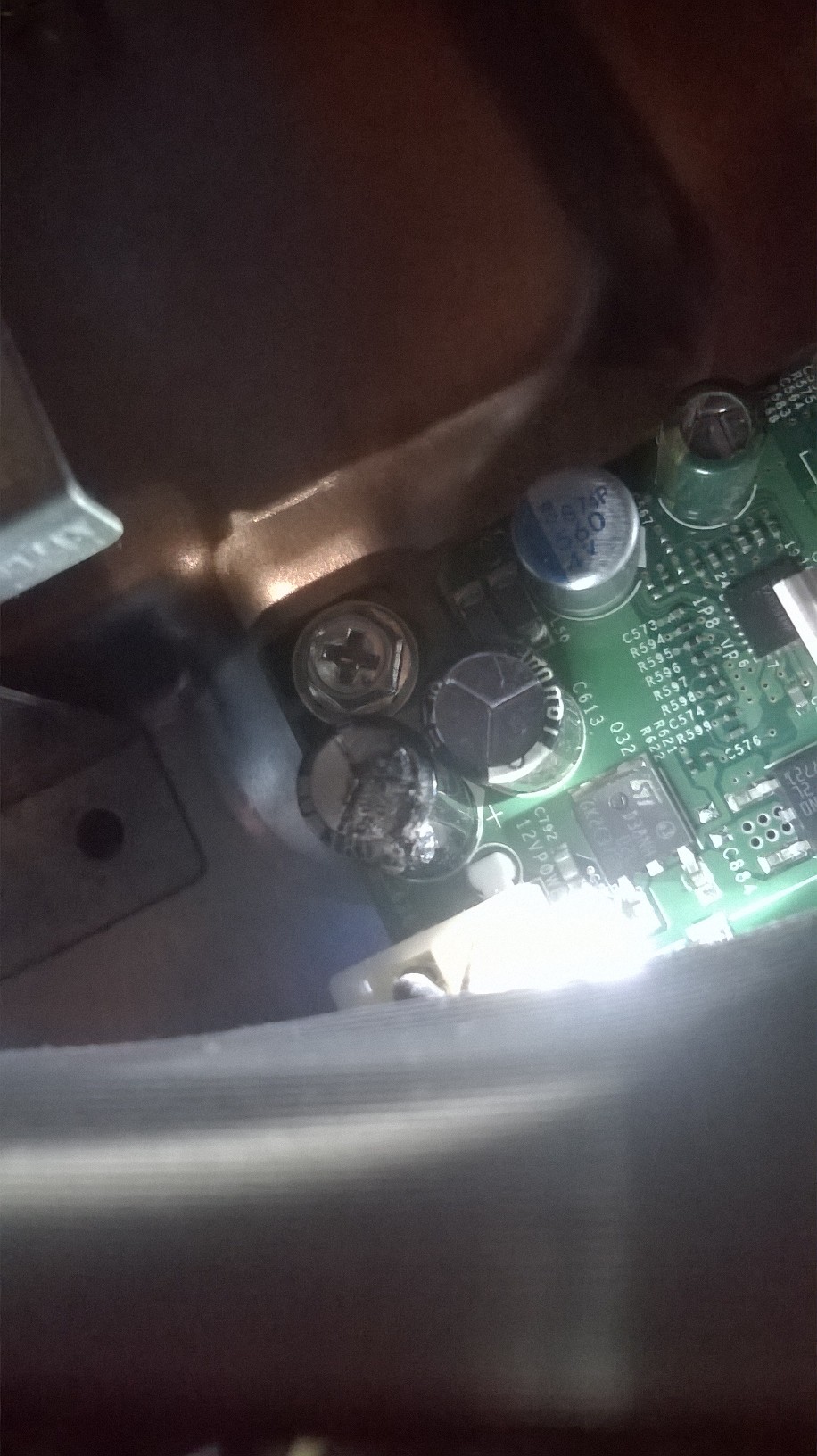

    Long story short , ive bought a pc from ebay and ive noticed that one capacitor is bulged and looks like its leaking
    however the pc seams to work just fine , i reported it to the seller and am awaiting a reply
    am i being overly sensitive or is this a big issue
    attached is a photo taken with a potato of the offending capacitor

    its extremely common with those models. Extremely. I had one that had 7 blown caps that still worked. It shoiuld be replaced since over time it might eat awya at the traces. Replacing one through hole capacitor is very easy to do.

    It needs replacing, that cap has failed

    Yup, definitely replace it. All sorts of issues can crop up due to failed caps, and it looks like it's already leaked. I'd be replacing other caps of that brand too, if it's a computer you want to use.

    Replace the caps or get a power conditioner. Cheaper to do the caps.

    Power conditioner isn't going to help you, that's not the main purpose of caps. Even if it did work, they will still leak and damage the board.
