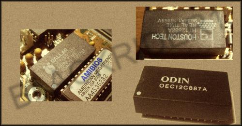

    I've just bought an old 166mhz PC for DOS games and general retro reminiscence, the only problem is that the RTC (Real Time Clock for those unaware) expired god knows when. The problem is it's soldered onto the board, and the real awful problem is it's a self contained device consisting of a chip, a quartz and a lithium cell or battery I'm told. I'll basically have to desolder this thing from the motherboard and ether replace it or modify the device with a new battery to get it working again.
    For those interested in some info on my predicament you can find info on the device (I say device because in my mind it doesn't quite qualify as a 'chip' due to it's composition):
    Odin OEC12C887A (info found on the below link)
    http://www.betaarchive.com/forum/viewtopic.php?t=22000

    OK, I'm getting the general consensus is that the desolder each leg individually is the best answer, using additional solder to start with and a sucker and iron to clear the joints then clean up any excess with braid checking the legs are free using a mini flat head screwdriver.
    Once again, thanks for the advice.
    I may make a start this weekend, or possibly next weekend depending on what I've got planned. I really had no idea clock batteries were this much of a pain in the arse to replace with computers of this generation. I really do feel like strangling the dick head who came up with the design for a closed off clock 'chip' - though I suppose in those days things were moving incredibly fast, they probably thought it'd get junked 3 or so years down the line.
    What's pissing me off more is it doesn't seem to want to 'see' my 10/100 NIC I put in there, or indeed the gigabit one I tried (both PCI), I have a feeling this has something to do with resources maybe but I can't know until I get the CMOS to stop defaulting every time it's turned on or reset. They both work in my P4 rig, but my P1 rig just can't see ether of them, even freezing on POST with the gigabit one (not surprised to be with that to be honest!).
    Well I'd need to cut into it (the RTC) to mod it and I don't have a dremel (see link on first post). I can't think of any other way bar a hack saw which would probably destroy it anyway maybe. But I definitely want minimal damage to the main board, and I guess I'll have to seek a replacement on ebay or the likes.
    Though modifying it would be the way to go since it exposes the battery inside the 'chip' making it easy to replace in future.
