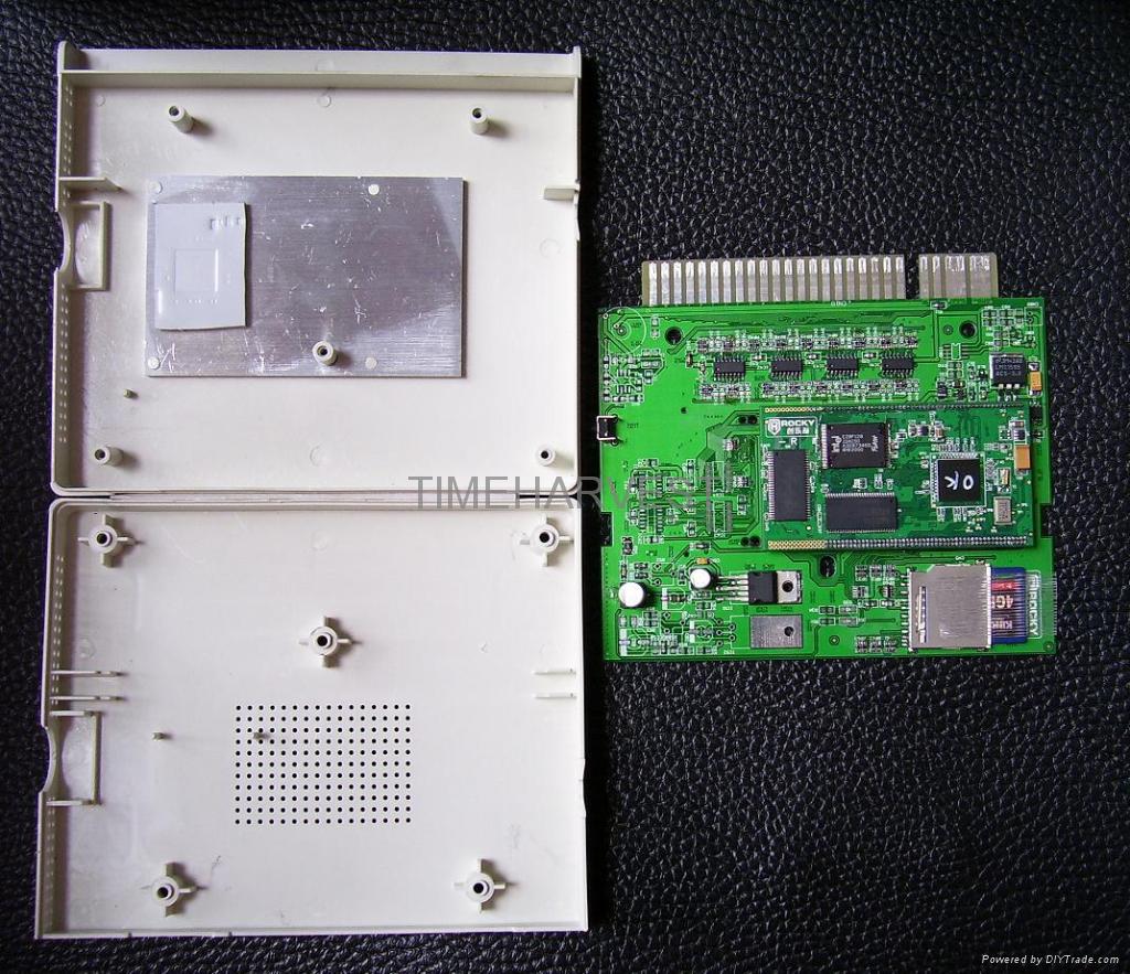

  6. madhatter256
    6,578
  7. aryssoR
    aryssoR Peppy Member
    Feb 14, 2009
    303
    That's a Blue Elf 1, the guts of it do look exactly the same though
