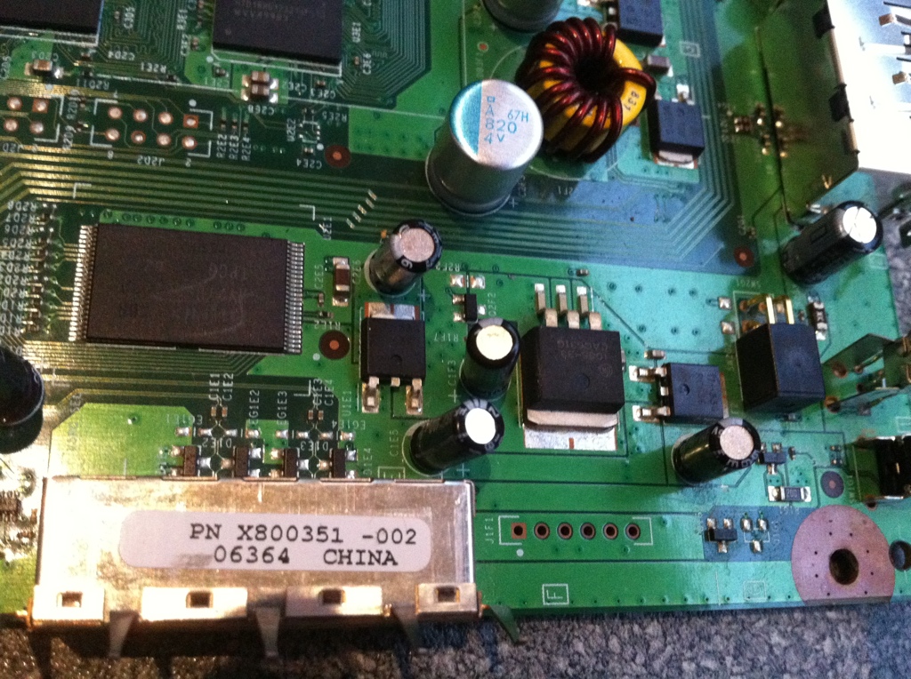

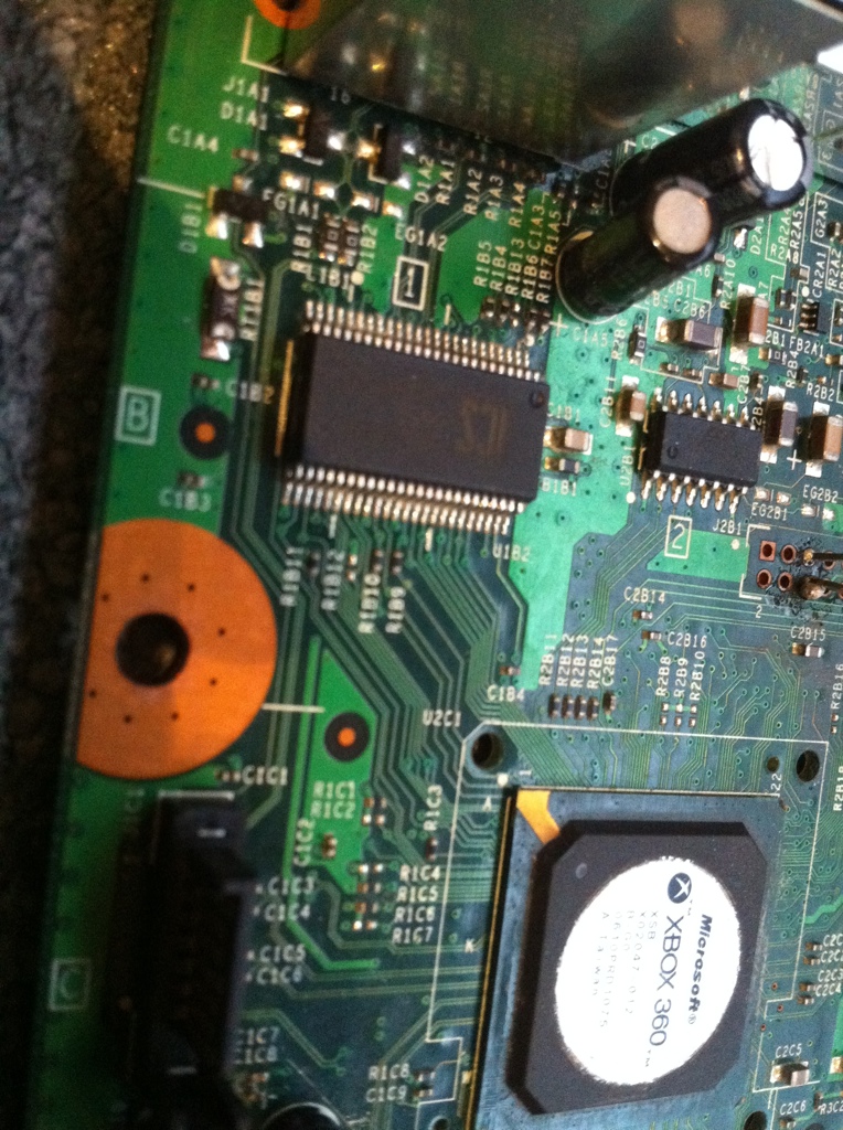

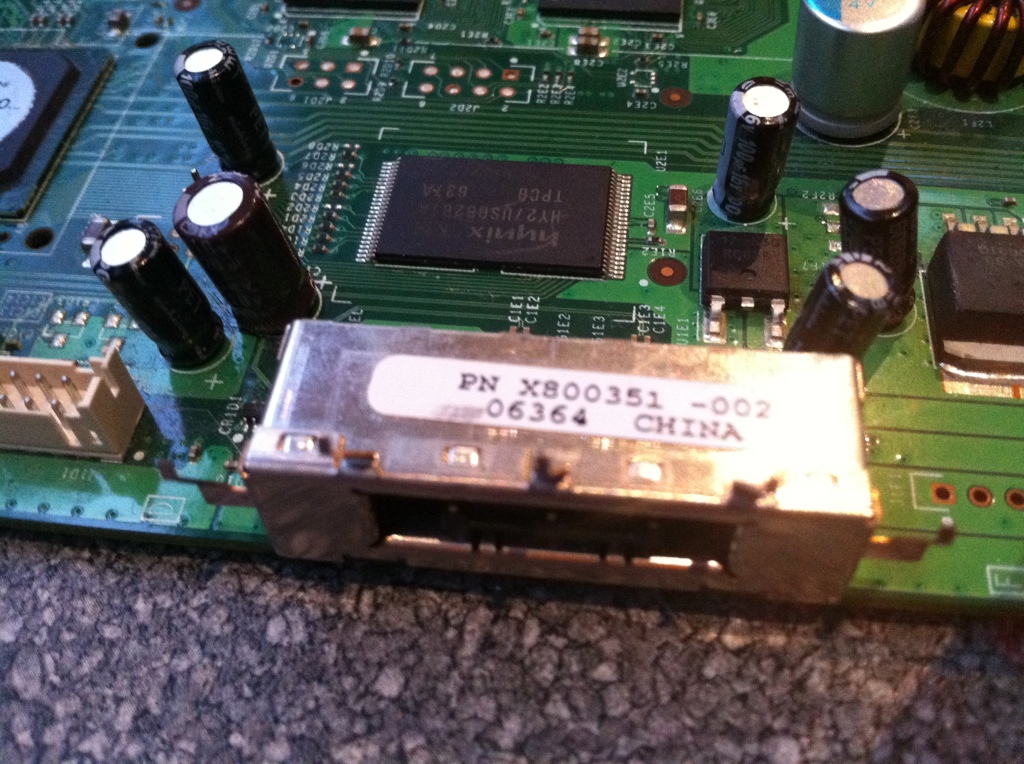

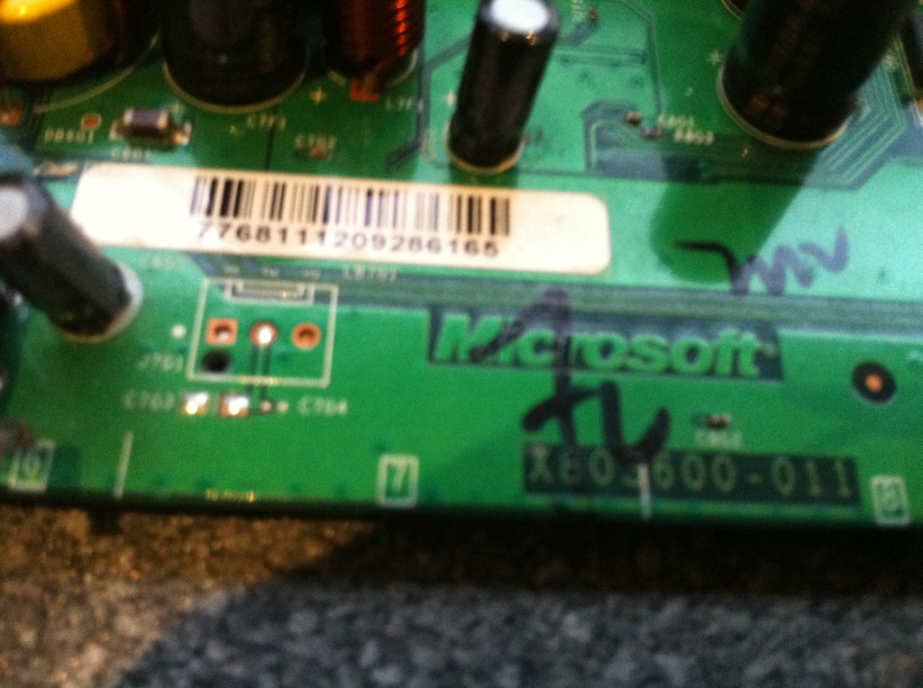

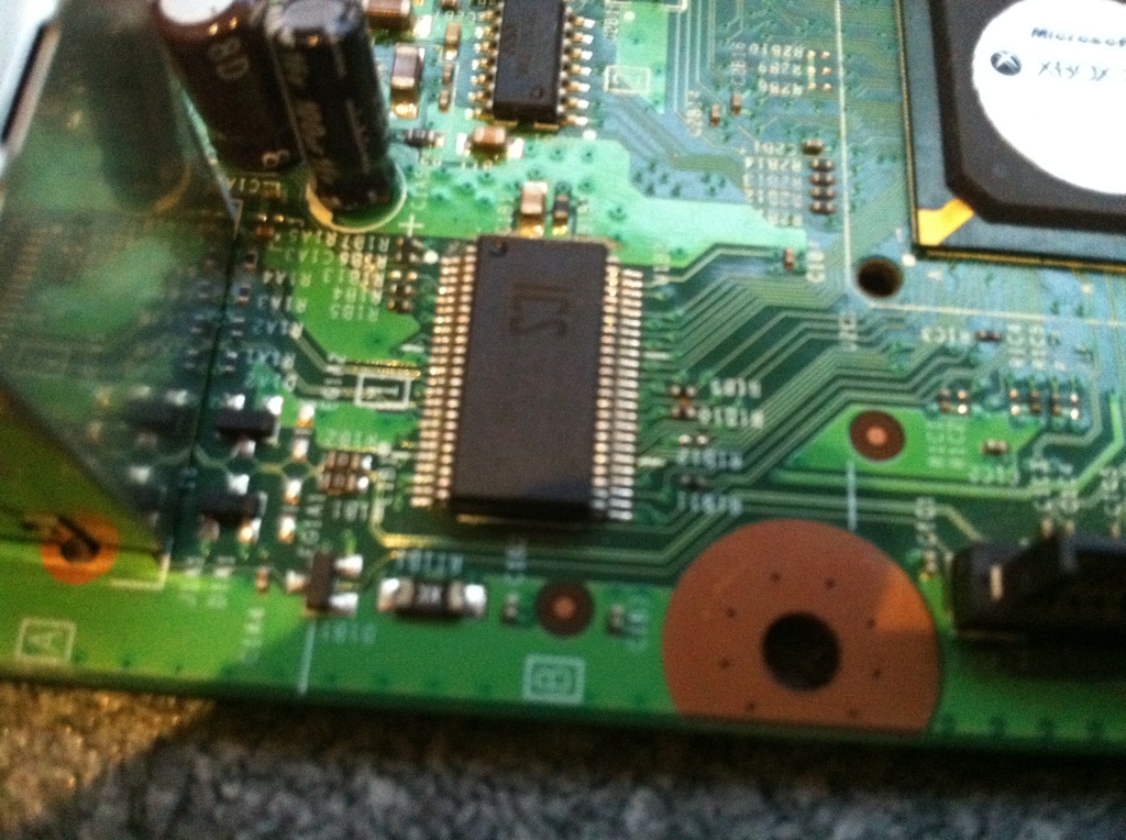

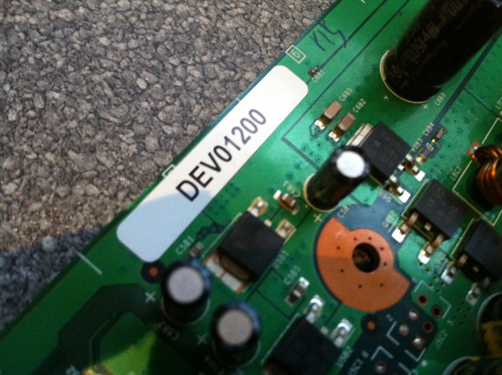

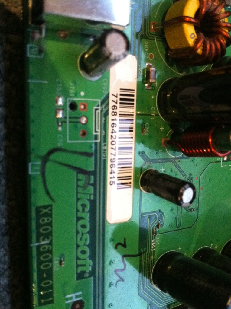

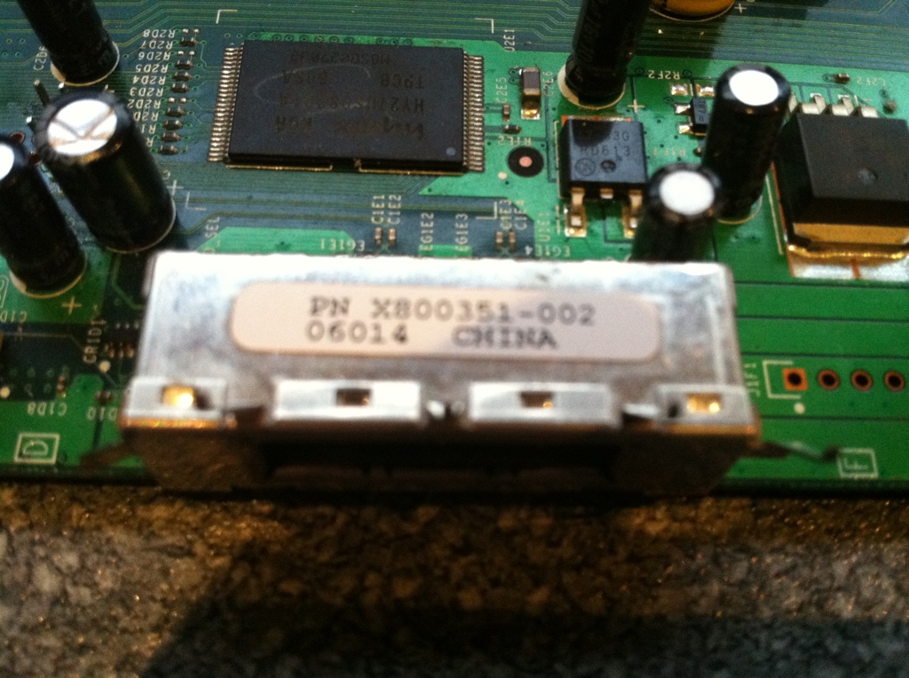

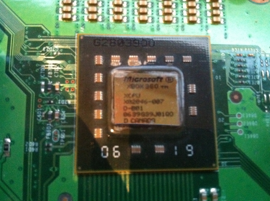

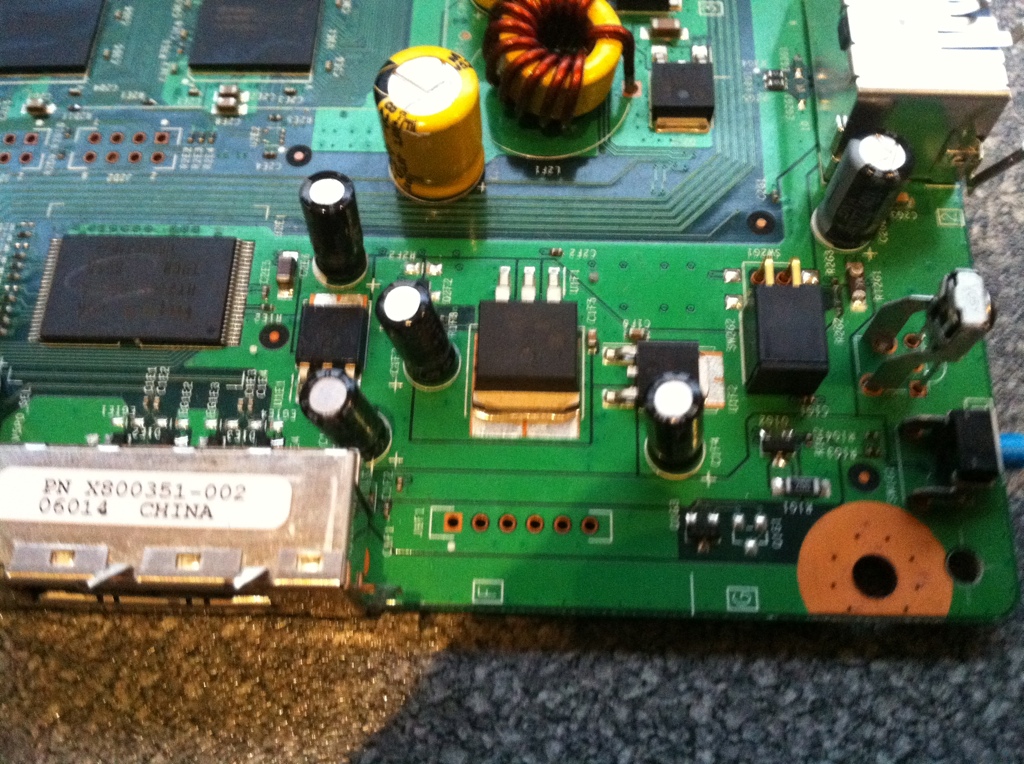

    Couple of boards I got in a job lot. I am not sure if they are Dev, was Dev or are just chinese fakes?
    This is what I get from Degraded does this mean retail? If so I guess there is a chance they have been flashed with retail by someone but are still dev hardware as they dont boot at present.
    CB 1940 LDV 0
    CD 8453
    CE 1888
    CF(0) 13599 LDV 14
    CF(1) 12611 LDV 13
    CB 1940 LDV 0
    CD 8453
    CE 1888
    CF(0) 12611 LDV 7
    CF(1) 12625 LDV 8

  3. ddxcb
    ddxcb Gota J.T.A.G. That Xbone Yo.
    Apr 17, 2008
    388
    To me it looks like a retail MB.
    Take a picture at the SB.
  4. sneakypeanut
    sneakypeanut Pika CHUUUUUU!!!
    Apr 14, 2010
    1,055
    there are some early retail boards floating about that say dev on them i guess they were converted kits or consoles used for testing

    Check the resistor configurations for the nand size, see if its a 64mb nand and your answer should be obvious
  12. ddxcb
    Apr 17, 2008
    388
    that and see what type of the nand flash it is. by the model number?

    I have a retail falcon that has a sticker that says dev on it like that "DEV02263-2", idk what it means but the sticker doesn't mean its a dev :p

    Resistors next to the nand work as a hardware way to tell the smc what size each nand is, different configuration of resistors input a different nand size.

    Console used for testing have a "table" below fan.
    This motherboard is retail.

    It's a retail, devs do not use patch slots for the kernel. Also your devkit fuse line is incorrect:
    Devkit: 0x0f0f0f0f0f0f0f0f
    Retail: 0x0f0f0f0f0f0f0ff0

    Same as retail so with that in mind its defo retail.
