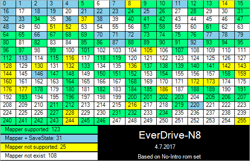

    http://krikzz.com/pub/support/everdrive-n8/mappers.png
    http://www.retrousb.com/images/mappers1.png
    http://www.retrousb.com/images/mappers2.png
    That's a comparison of mapper support currently. EDN8 seems to be better than the provided mapper files for PowerPak, but I know that a few people released third party mapper files that work with it, which retrousb's picture doesn't account for.

    Actually, Castlevania III does work on the PowerPAK now. The official supported mapper picture/grid hasn't been updated in awhile.
    The PowerPAK supports just about every mapper except those used by chinese pirate cartridges. It supports, NROM, CNROM, MMC1, UxROM, MMC2, MMC4, MMC3, MMC5 (enough to run CV3 atleast), Konami VRC2, 4, and 6 with expansion sound, FDS with expansion sound, I think it has Namco 106, unsure if it has expansion sound, Sunsoft 5B with expansion sound I think, and those are pretty much all the main mappers. Well I forgot GNROM and AxROM which are both supported too. It's mainly pirate mappers like JY90 that aren't currently supported. But the PowerPAK pretty much plays almost all licensed games. The only ones that might have trouble are MMC5 games that might rely on features not implemented yet.
    The PowerPAK supports FDS, you'd have to name a game that actually is more than one disk, I've never heard of them and I can bet you whatever it is isn't worth playing. FDS support in the PowerPAK is good. It is definitely true that the PowerPAK doesn't work on most clone systems.

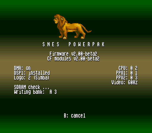

    Super cool and ultra flashy update for the snes powerpak. At nesdev in the snesdev forum. I hooked it up and its amazing. And you can customize colors and images on it.

    Again, I don't see what you expect to be better on the part of the interface. You can't make a pretty picture or anything while browsing a file list. And there is virtually nothing else to do other than pick a game and run it. As noted, the SNES PowerPAK has gotten a nice software update recently, but that's SNES. You can make a very pretty interface with that.
