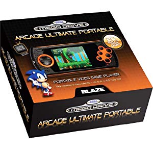

  3. Yakumo
    Yeah, but those Mega Drive on a Chip systems have shit audio and some graphic problems. I'm a big fan of the Yamaha FM Synth sound. The Mega Drive when use correctly made some amazing audio. 90% of it was Japanese mind you since most western developed games (Especially from the US) used that shit known as Gems for a sound engine.
