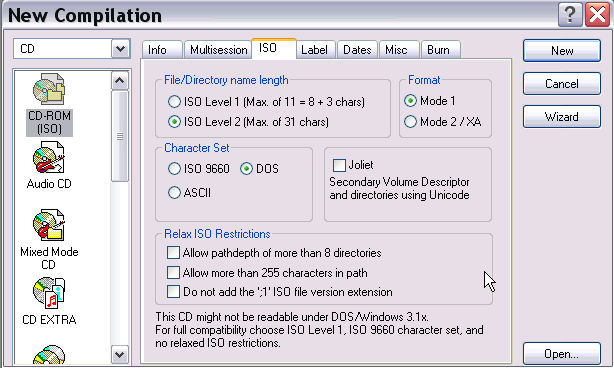

    After researching some more I remembered the v64 files needed to be burned it a special way, I burned a data cd using nero 5.5 with the settings seen in the attatched picture.
    But alas, it did not fix anything, and I got the same error.

    burn the disc with ISO Level 1 and NOT Level 2.
    if that won't work, test the cd drive with a music cd. the Doctor V64 should play it. use a original disc and no copy. if the V64 can't read the disc, the last thing you could try is a bios update (V2.03 is the latest). a friend of mine had problems with his V64 too, after a bios update his machine worked fine.
