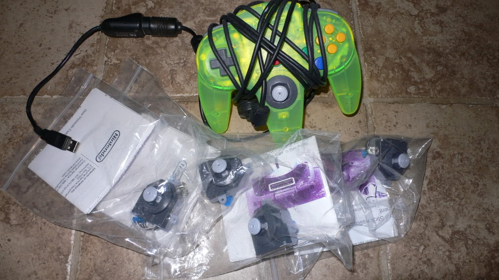

    Nintendo had had no problems selling new replacement thumbsticks some years ago, so yes they were a user serviceable part once. They just run out and didn't bother making new ones.
    They came in little bags complete with instructions etc.
