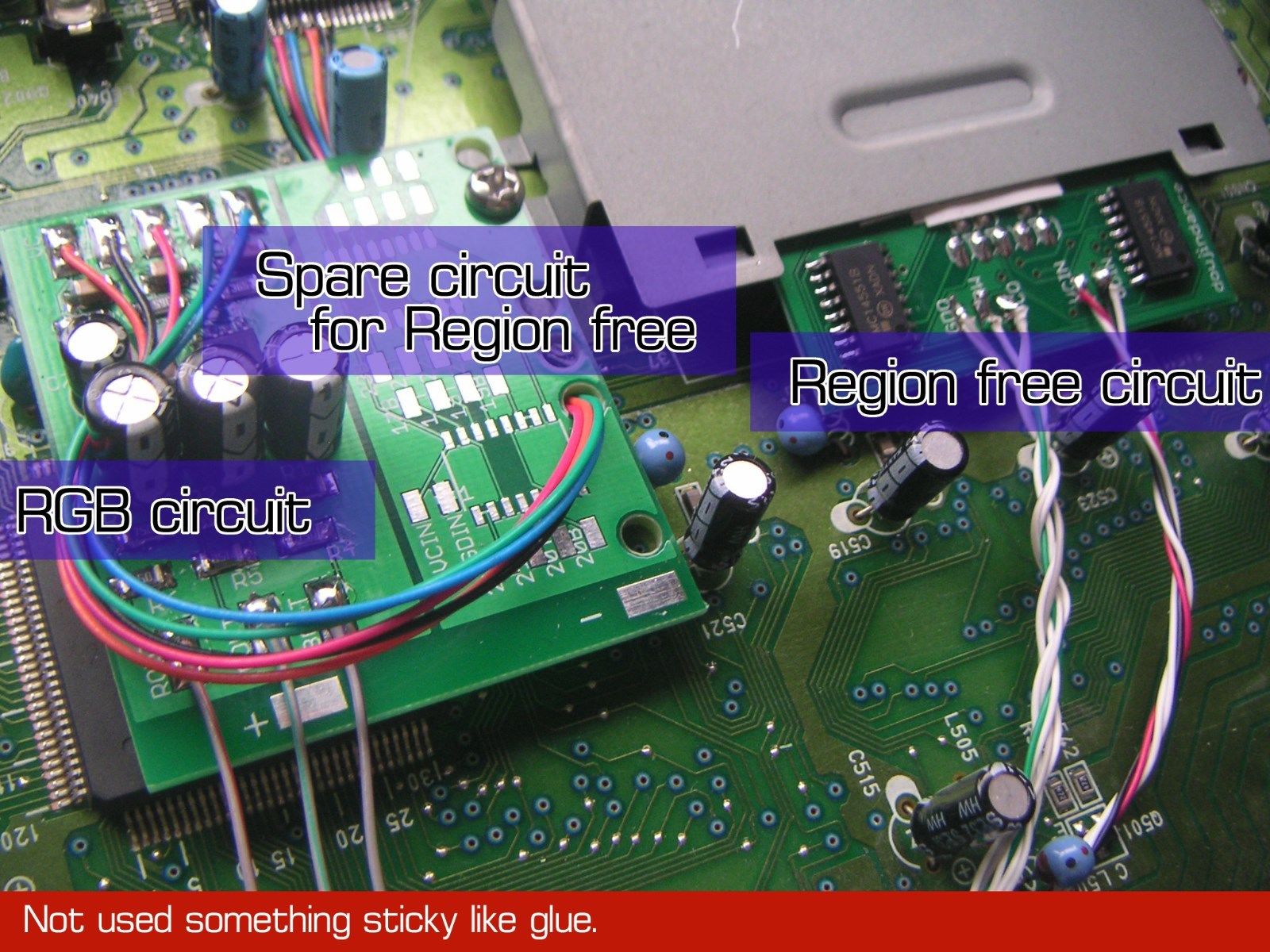

  7. awesomeNES
    awesomeNES Peppy Member
    Jul 30, 2015
    335
    114
    He made his ebay listing look very nice, though.
    "Not used something sticky like glue" LMAO
    AUSTIN PEYTON, voultar and Bearking like this.

  10. -=FamilyGuy=-
