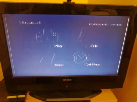

    Hey all.
    I recently bought a Dreamcast, it was like 90$ (PAL version) because its really rare in my country.
    So anyways, I hooked it op when I was home and it was working good, I unplugged it and moved it inbetween my other consoles. Suddenly, the picture of my Dreamcast is all blackened.
    (This is from another user but it looks exactly like this)
    I have no idea how this has happened or why, but I tried to clean the ports but that did not help.
    Any fix for this? I really need it.

    Are you sure your tv can support as 50hz signal?
    Try running an american or japanese game and see if the picture is ok

    I put a game in it and the screen became greyish and began to glitch a bit (lines flikkering across it).
    It started the game but I could hear the sound really good and could press buttons but there was no screens only a glitchy flikkering.
    Is it the cable?
    EDIT: Yes, its runs on 50hz all the time.

    looks like you're getting sync but not RGB from the scart cable
    wasn't there a thread on this exact problem recently?
    if you're tv gives you the option make sure the SCART mode is set to RGB or try cycling through the options, open the end of the scart cable and make sure its all connected and nothing is grounding or shorting.
    open up the dreamcast and check the AV port incase someone has screwed with it or tried to do a VGA mod and messed it up

    OH YES!!!
    yeah it's your RGB cable, had the same issue on a master system I rgb modded on a TV which had issues with switching to RGB mode and only showed the sync
