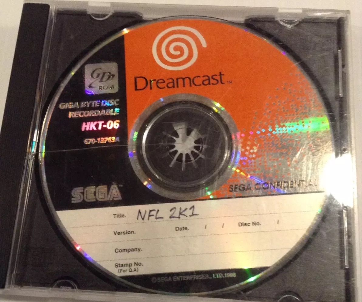

    I bought a disc that looks like this:
    Can it be played on a retail console?

    Yes you can!
    You got two options:
    1) Buy a "System Disc 2"-bootdisc which was made specifically for developers and members of the press to boot these type of discs on a stock Dreamcast. (Don't bother a copy of the internet, it won't work)
    2) Perform the swap-disc trick with a disc with the same amount of "tracks" as this one.
    Goodluck :)

    240
    With the second option, how do I tell how many tracks the dev disc has, as well as the disc used to swap? and can that damage either of the discs or the dreamcast? I would have to borrow a friends dreamcast to test it, seeing as I don't own one yet, and I'm sure he won't be happy with me destroying his discs.

    The easiest way to find out how many tracks a game has, is to simply do a check if you can find a GDI dump of the retail version on the internet. When doing this for NFL 2K1 (http://redump.org/disc/22155/) you'll see it's a 3-track game, which means you can use the majority of games for the swap (e.g. Sonic Adventure or NFL 2K1 retail).
    Doing the swap properly without rushing it will not jeopardize your disc nor Dreamcast system. I don't have any guide for this ready, but a quick google gives you the following guide: http://www.thegypsy.com/dcswap/

    1. Remove the top case
    2. Short the Dreamcast battery (we need this so the Dreamcast to lose its time)
    3. Hold the black lid switch with rubber band
    4. Put the normal disc and boot the Dreamcast
    5. Wait on the set time screen for the cd to stop (2 min)
    6. Change the cd and press A to boot!
