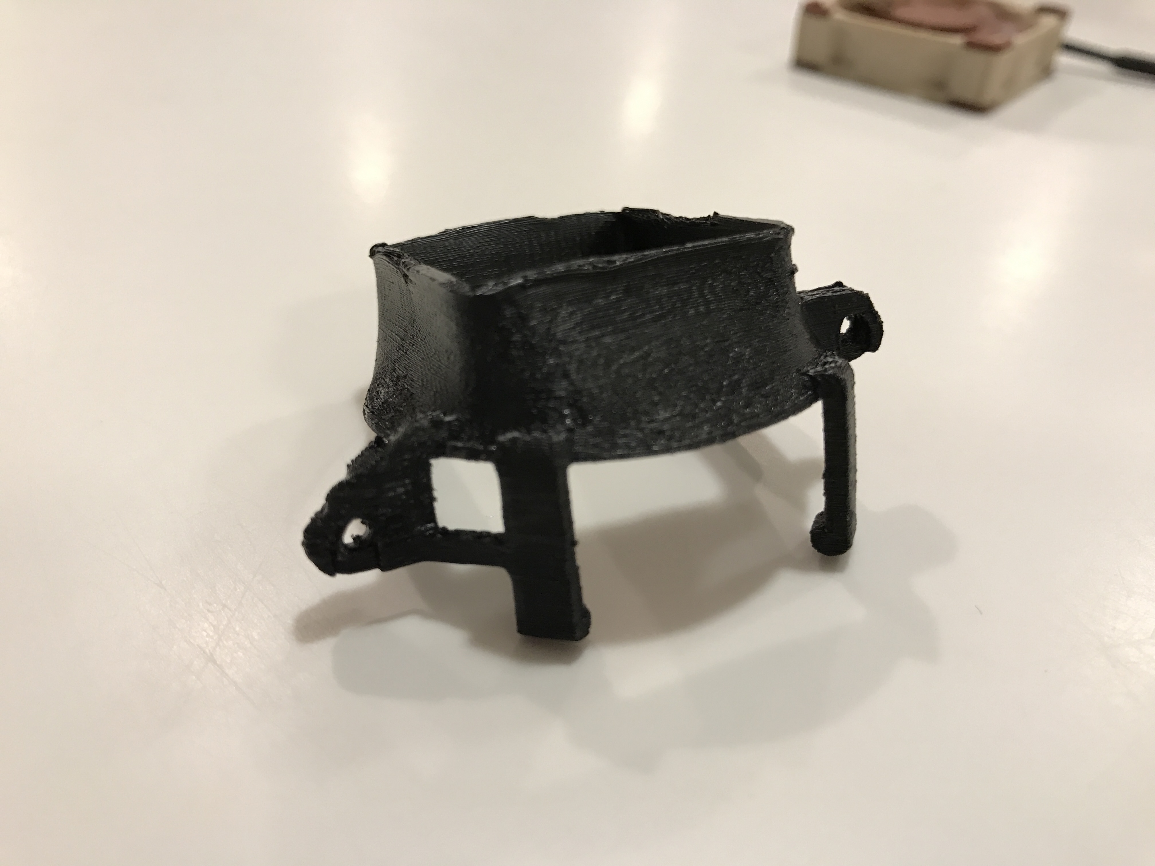

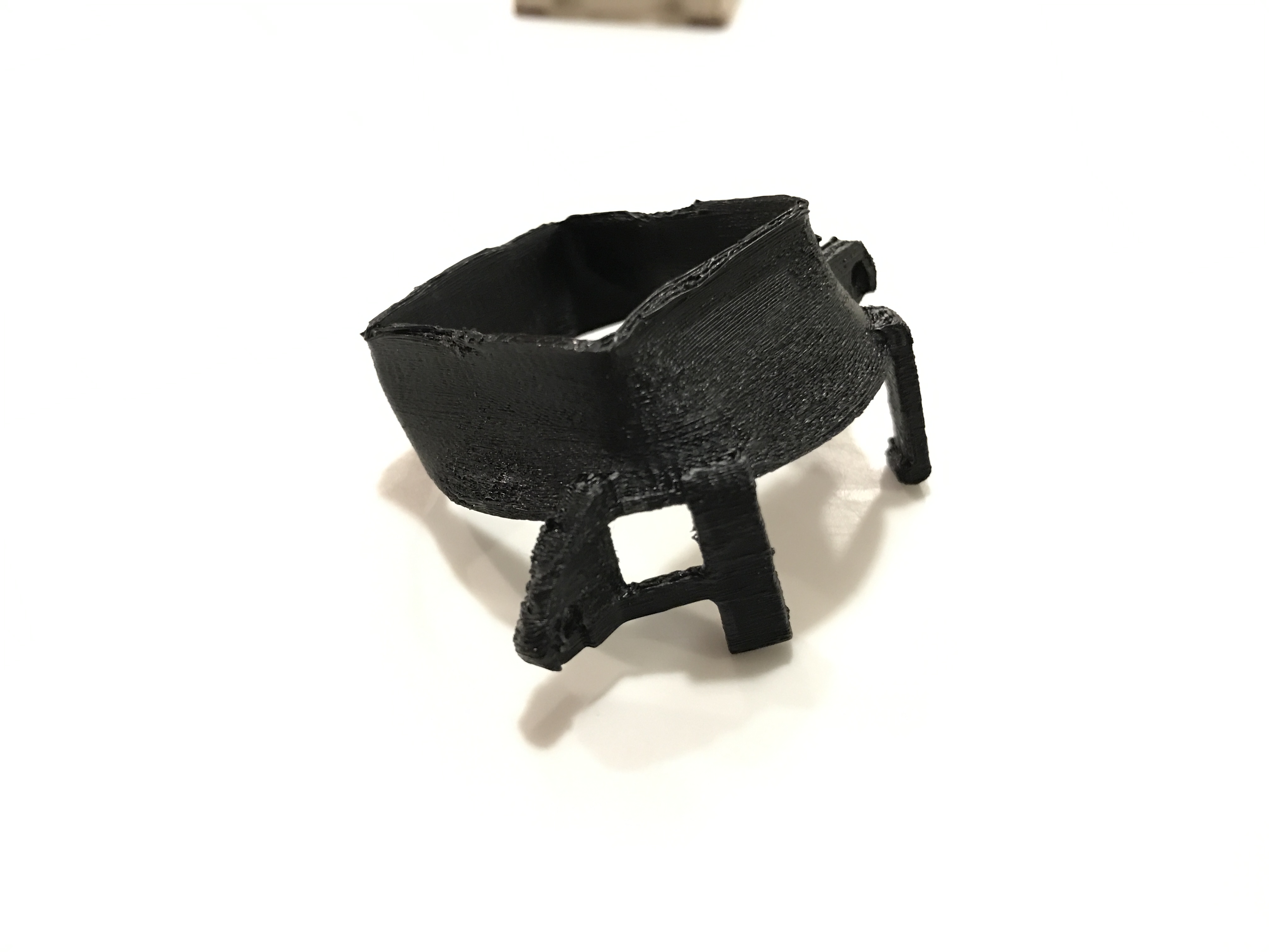

  8. Xerxes3rd
    Xerxes3rd Rapidly Rising Member
    Sep 1, 2016
    96
    35
    I finally printed one. I used 100 micron layer height like we previously discussed. Mine didn't come out nearly as clean, but I think my extruder is over-extruding. I also realized that rotating it "backward" 90 degrees doesn't make it lay down totally flat, so that might have contributed. At any rate, though, I think it'll work, even though it's a little ugly. =)

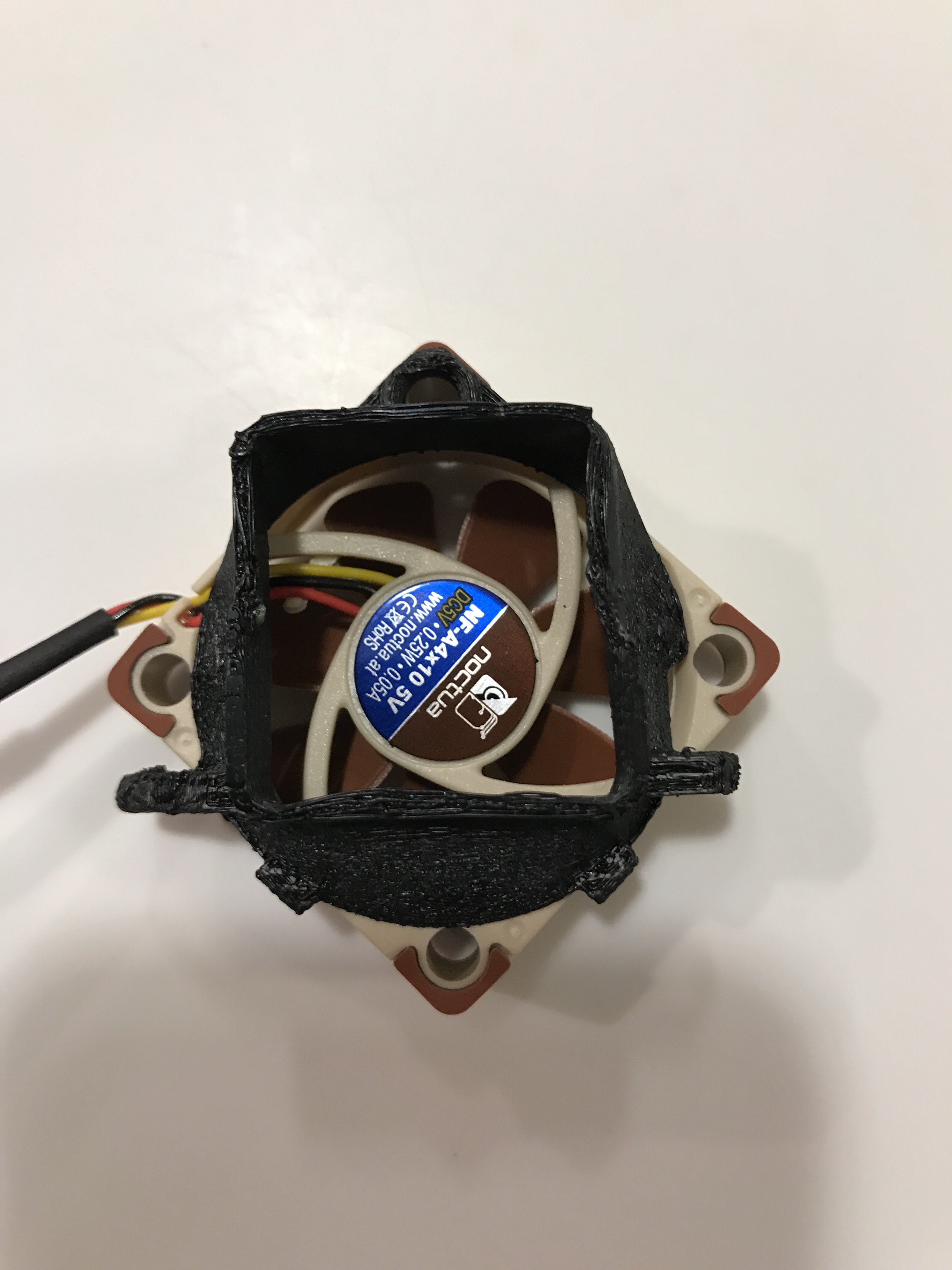

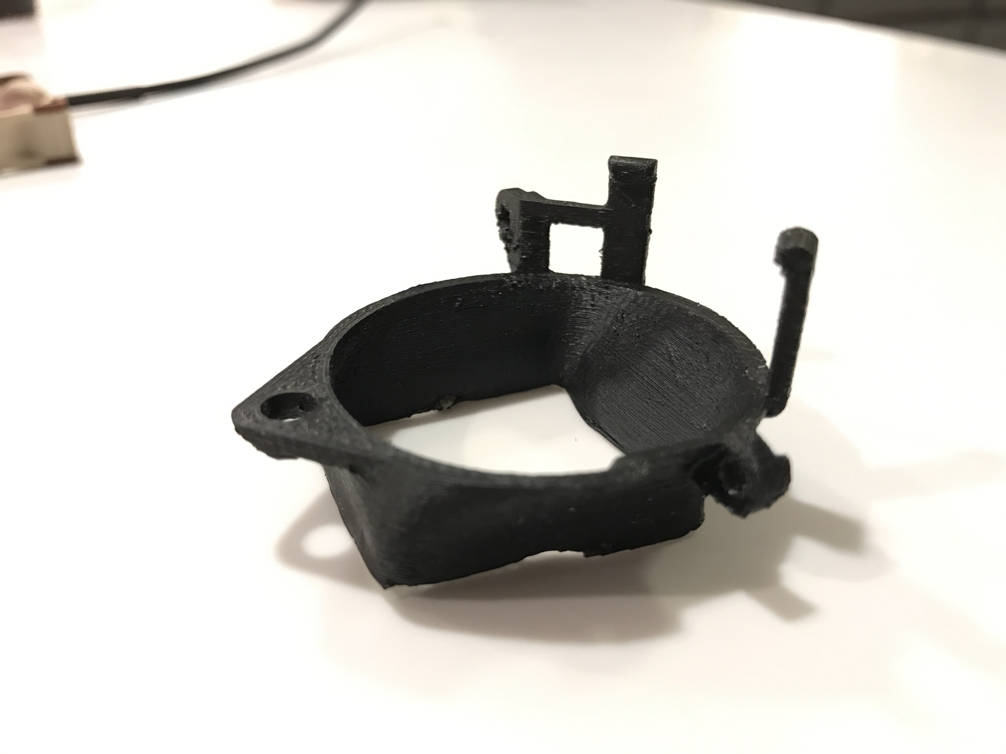

  20. Collingall
    Collingall Robust Member
    Jun 13, 2016
    210
    131
    I haven't printed the most recent revision to the new duct yet, but I do have it available on my Thingiverse page
    https://www.thingiverse.com/thing:2308549 If anyone wants to download it.
    The one I show in these pictures is made from PETG I apparently lost one of the screws, I will have to track one down in my screw bin.
