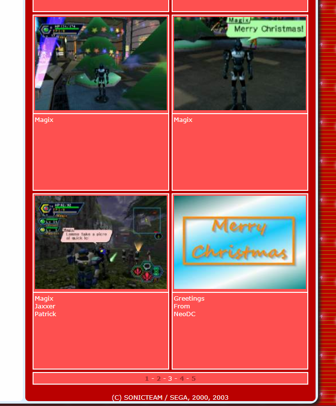

    Over discord tonight r0r0 and I figured out how to correctly set stuff up in order to upload from a dreamcast and spit out VMI/VMS combo in a webserver.
    This isn't anything new, but both of our programs we'l be open source and public.
    His is written in node js and mine in php.
    Along with that, yesterday I figured out how to read pso screenshots from a vmu file and then for extra fun, how to reencode. So that code will be public as well.
    The whole goal is to keep this information public, free and accessible.
    Maybe poor taste, but here's an example I put up on blueswirl as a PSO screenshot

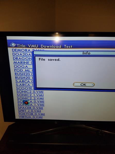

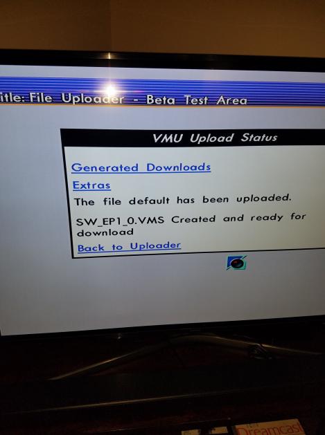

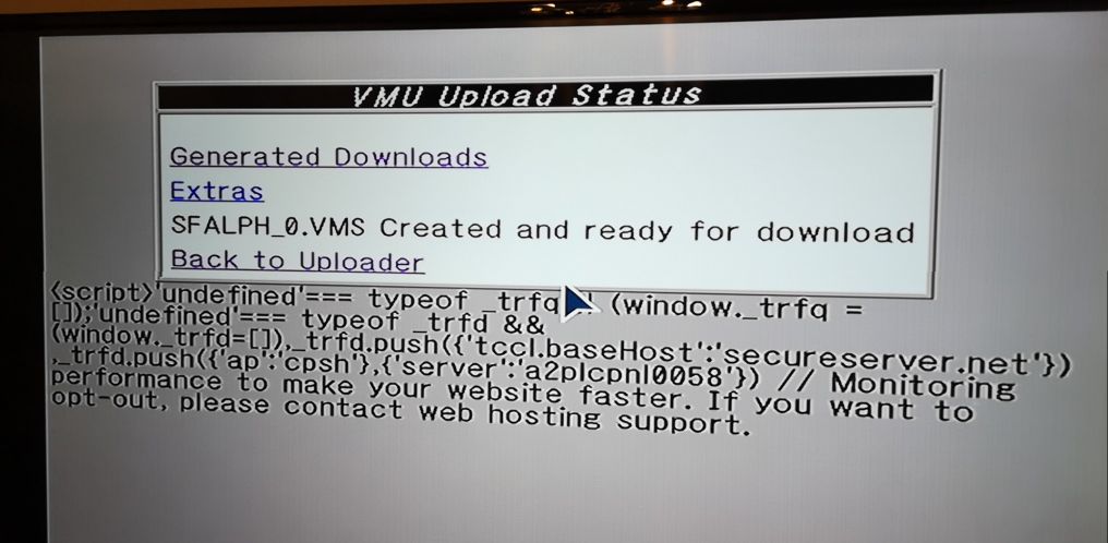

    Ok so after a brief moment where my entire harddrive was wiped, and then i had to rewrite it all from pieces i could remember, it is finally here!
    But yes now there is a completely FREE and Open Source way to do this that should be able to live on for as long as the internet.
    Current Features:
    • Upload VMU Saves from at least 2 DC Browsers (PlanetWeb 3 and DreamKey 2)
    • Download VMU Saves to at least 2 DC Browsers (PlanetWeb 3 and DreamKey 2)
    • Generates even more correct VMI to go along with a VMS file
    • Decodes/Encodes PSO Screenshots saved from the dreamcast
    • Will Generate a correct Icondata.vms for use on the console
    • Reads VMI Files and can dump the info contained
    https://github.com/mrneo240/NeoDC-Icondata-Tool/tree/master/vmu
    so the code lives there at the moment, and is in desperate need of cleanup and comments. After losing all of it multiple times though, i figure it should at least be thrown up on github for now.
    imgpsh_mobile_save_anim.jpg working upload from DreamKey 2.0
    20181222_145710.jpg working upload from PlanetWeb 3.0
    20181222_145822.jpg Working download of saved games from PlanetWeb 3.0
