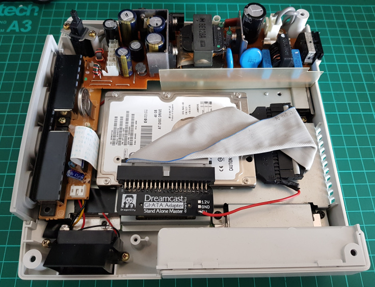

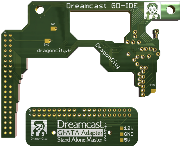

    It seems there is a new IDE solution for Dreamcast courtesy of the French site DragonCity.
    It lets you connect an IDE hard disk or via adapters a SATA / SSD or Compact Flash drive. This adapter works with Dreamshell bios or DreamShell Boot Loader CD.
    • You can always use the GD-ROM drive!
    • Ability to move the GD-IDE to another console
    • Ability to boot from a Dreamshell SATA / SSD
    • Nothing to cut, your console remains intact!
    • Ability to boot bios WITHOUT Dreamshell with cd boot

    You have to build it yourself, so most of us can't use it. Also, what state is Dreamshell compatibility/performance wise now? Used to be terrible.

    Took a look, I think you still have to patch ISO's and the latest is 2 years old. Bad.

    About 80% games are compatible.
    There was a little update of isoloader last year for Shemue I.
    You can run homebrew emulator and a lot of games.
    Megavolt is working on a new update with 2 hdd and a video player for ide dvd.
    For now swat is mobilized on the russian soccer world cup, he'll go on dreamshell after that.
    Maybe he could give a date of the next release.
    thedoctor45 from dreamshell forum has done a pack with all homebrew (except last homebrew selling than alice dream tournament, 4x4jam etc... but you have half life, propeller arena for example) all emulators and all of official games running dreamshell.
    I can share with you in PM the torrent of about 80Go of games !
    Dreamshell is the cheapest system you can install and those cards are about 25euros with bios.
    the gdemu are at 130e are very hard to catch and the usb gdrom are at 200e

    g1 ata is a good solution cheap and here and now upgrade. unlike gdemu which is a jackpot to get. one year now i try to get one for a friend without luck. the compatibility of g1 ata will improve with time im sure.

    He posted pictures of the first version on Twitter, the only issue there is the barrier to entry. BGA soldering on a few chips will make it near impossible for all but a few. It will still be sweet to see it running on a smaller form factor when it's done though.
