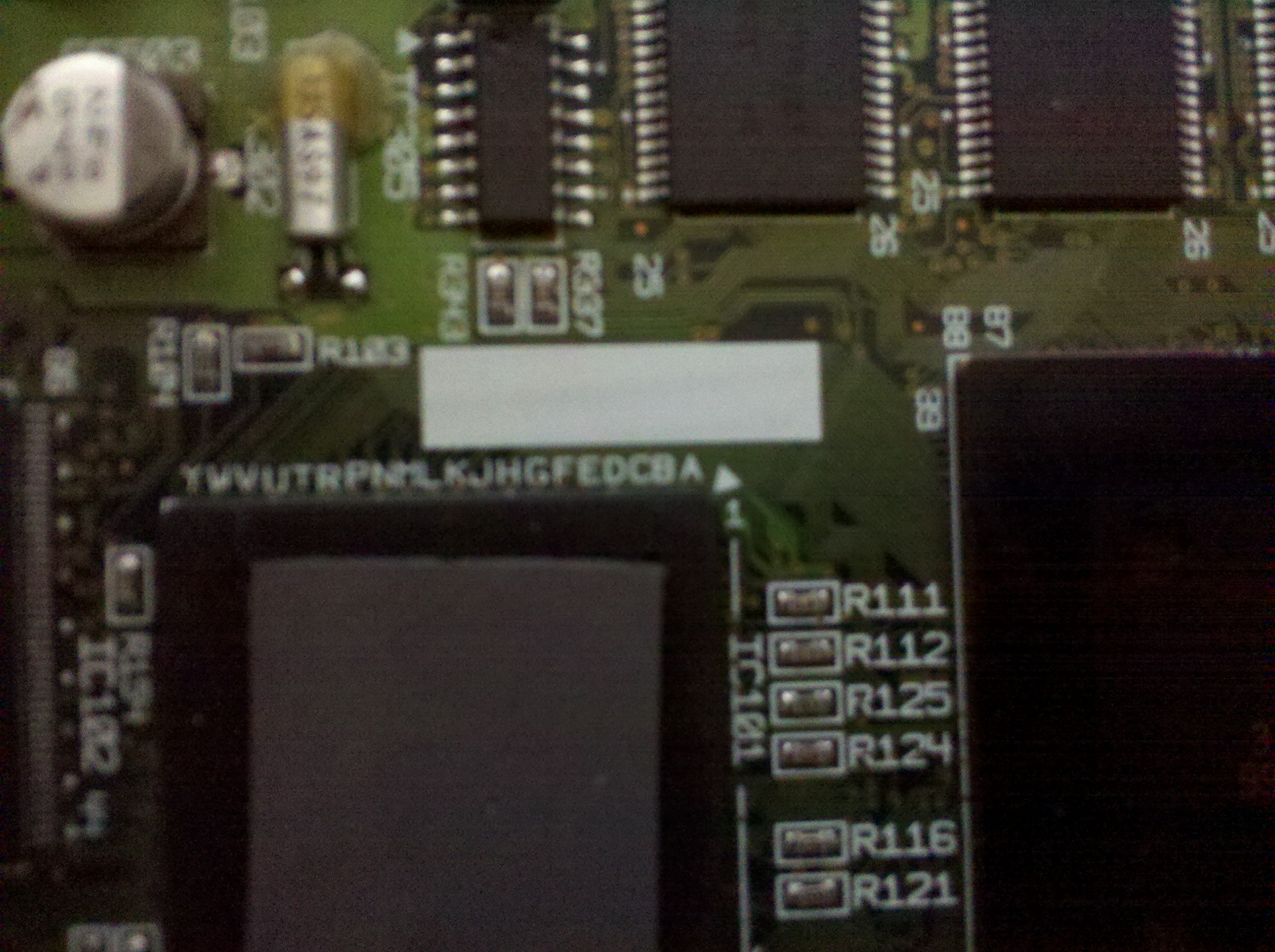

    Could you look at that part of the board and tell me if there is any damage to that white rectangle area?
  9. stones863
    stones863 Member
    Apr 16, 2012
  10. Hedgeyourbets
    Jul 19, 2011
    743
    Odd :/ Ok well I'm stumped

    ya i cant figure it out it worked greeat b4 then i added the wire and now nothing, have about 6 hours of going over it with a magnifying glass and havent found any burnt traces so it has to me internal on on of the ics
  12. Hedgeyourbets
    Jul 19, 2011
    743
    Well occam's razor and all, one of the chips has indeed probably died then
