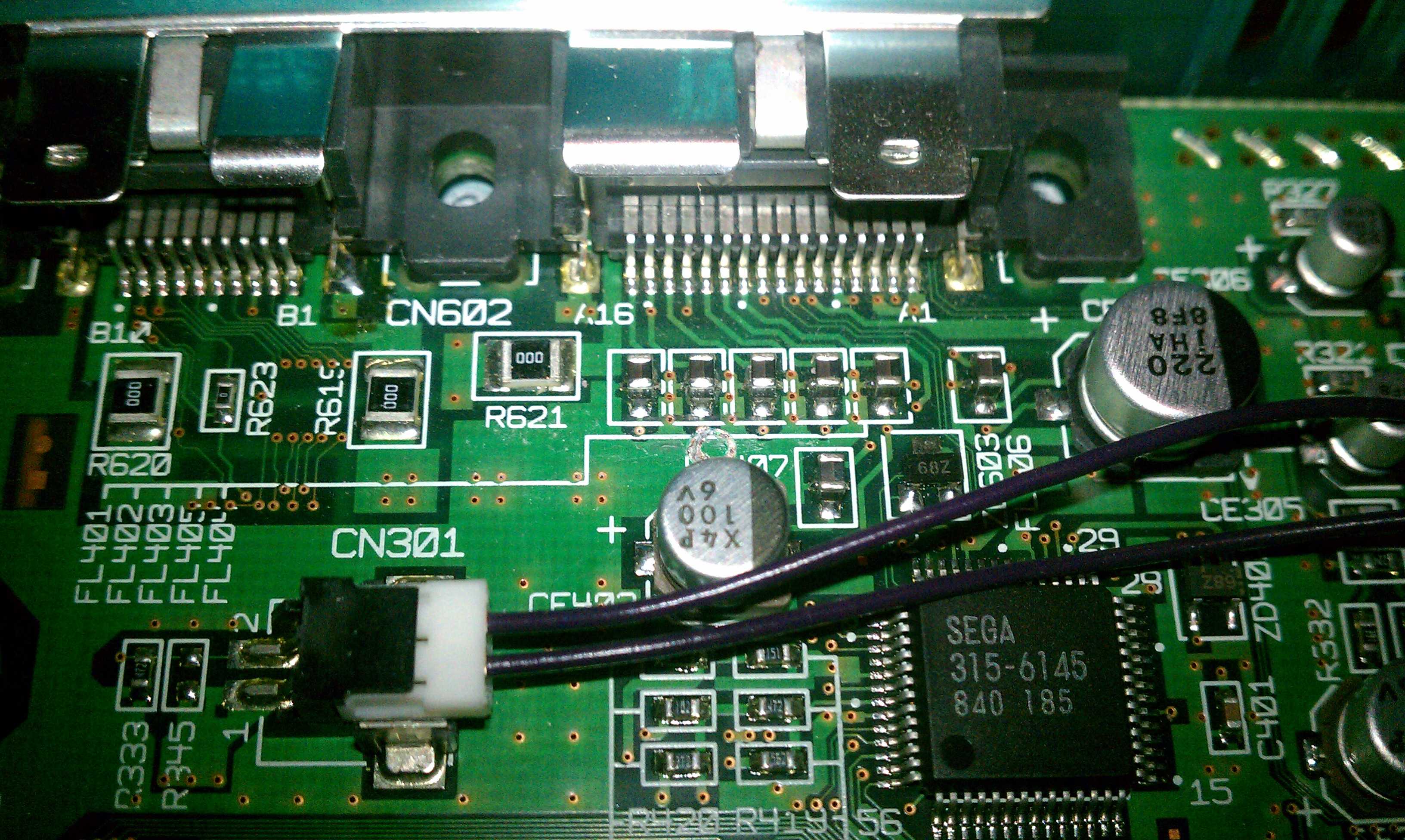

    After re-assembling my Japanese VA0 Dreamcast I accidentally screwed the GD rom drive to the metal shield using one of the long screws instead of the short screws. Got the GD rom and controller port screws mixed up. I didn't notice I had done anything wrong until I tried to boot it up and was getting no video after getting video just minutes before. After researching, I learned about how the long screws can damage the main board if screwed through the GD rom area which is why I am now aware of what happened.
    Now I know my mainboard is now in need of repair, the question is, out of the two danger screw holes on the GD rom unit, did I pick the lesser of the two evils to screw the long screw into? I put it in the back left corner of the GD rom, the front left corner I put the correct default short screw in.
    I took pictures of the damage on the mainboard, its right above the metal capacitor and to the right of and a a bit down from where R621 is written, you an see a metal ring where the screw etched into the board. What exactly did I hit here and how would I go about fixing it? This Dreamcast is pretty important to me as I looked for a VA0 for quite some time, so buying a random new Dreamcast isn't what I had in mind. 044.jpg 045.jpg 044.jpg 045.jpg

    That said, thats pretty easy to fix. Just clean up the area and fix the via you have destroyed.

    from the pics it looks like you have broken a trace, could have been worse, just bridge it with some solder

    Lucky you, it's not the critical brick-spot on the left...

    I could be wrong also, but from the photos it looks like the row of five components (either resistors or capacitors) above the damage, connect through to the flip-side of the PCB. Therefore it's most likely the second component from the left in that row has a trace broken, or is being inadvertently grounded by the damage caused there.
    Check for low resistance with a multimeter (in diode mode). If it confirms there is a connection to ground then, as mentioned scraping away some of the damage there may restore the connection. Worst-case scenario is you'll have to bridge the trace to the underside of the board.

    If you follow the white line leading from those components, you can see the parts are labelled.
    These are inductors, but are generally used for signal filtering, so the labels start with "FL".
    The part near the damage is FL402, this is the inductor for the GREEN video out signal.
    On the VA0 schematics (from the forum sticky), this is confirmed as you can see the trace connects to video port pin A15.
    (The FL402 part is near the right of the "video_dac.jpg" diagram, and the video out port is on the right of the "connectors.jpg" diagram.)
    If the damage has broken the track or even shorted it, I'm not sure why this would stop video output completely unless the DC is capable of outputting component video?? (component uses "Sync on Green").
    It doesn't actually look that bad from the photos? Do you think the board was pushed down quite far?
    I suppose it could have overloaded the DAC though? Or, the damage has gone through some lower layers of the board?
    I'm not sure how many layers the DC board has, but someone on here or benheck is likely to know.
    EDIT: I've just seen on @bacteria's DreamBox build on benheck that the DC board is only two layers apparently.
    What I would do first is to clean the board slightly with a soft brush, and maybe a small dab of IPA (Isopropyl Alcohol).
    You might be able to see the damage more clearly then.
    Do you have a VGA box / cable? Give that a try if possible.
    And yep, a multimeter check is a good idea. Check between either end of FL402 and Ground (any of the exposed copper around or above the screw hole on the left).

    Like I said at the other thread, that damage on the video region would not stop the Dreamcast from booting. So there would be sound.

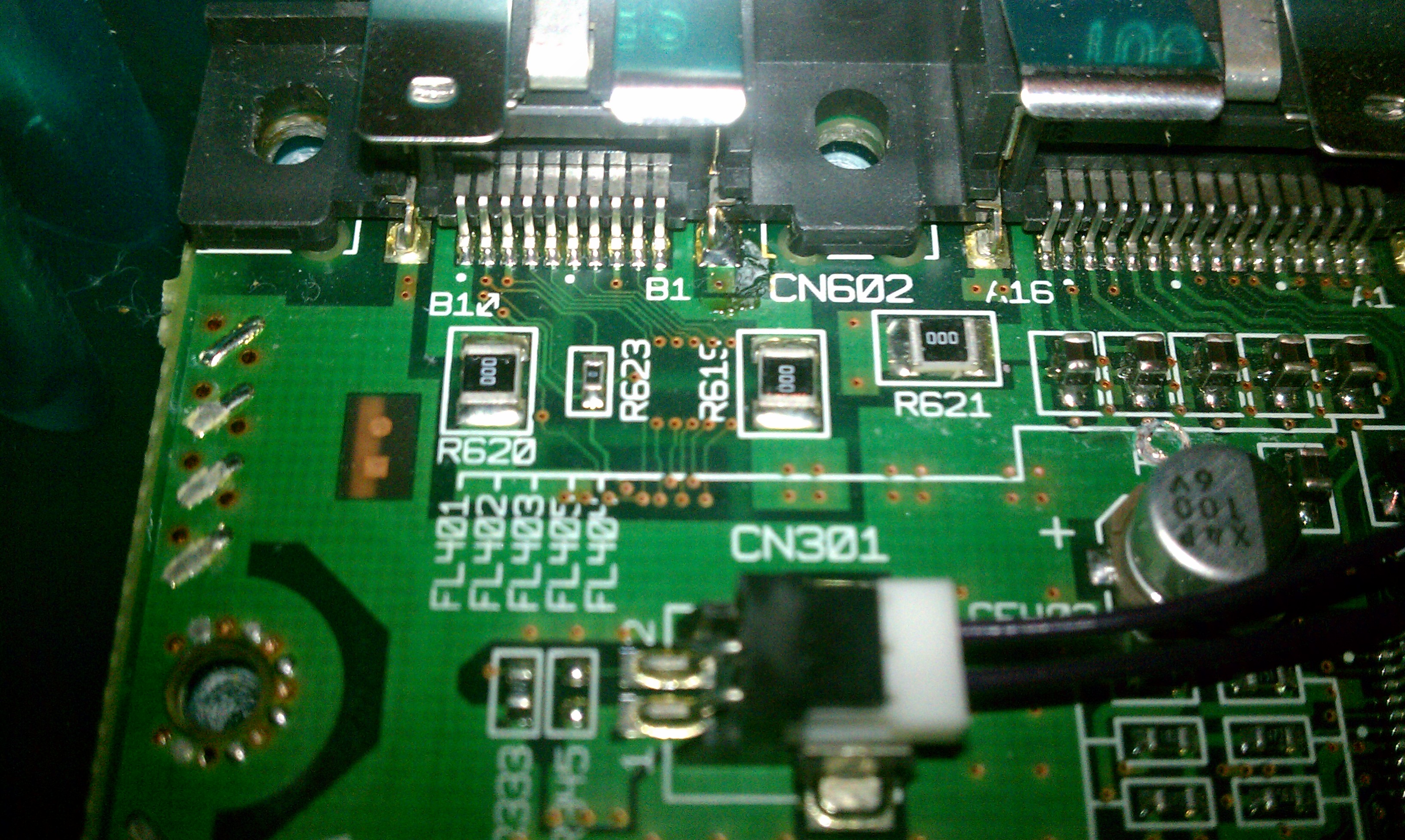

    Thanks for all the responses guys. I did a heavy cleaning of the damaged area still no video output so I re-examined the entire board in other areas. It seems there is tiny damage from a screw going into the bottom left GD rom hole as well.(the first pics of damage were from a screw in the top left GD rom hole.) I did not notice this mark because it is not as pronounced as the other, I guess the screw did not penetrate as much.
    However, this damage is directly over a bunch of tiny traces which go right to either the GPU or CPU)It's one of the components covered in a metal block so I know it's one of those two.
    Anyhow, these traces are so tiny that I don't know how even an expert could fix it. I will post pics up later to at least give it a shot.

    Yes, it's that one which is preventing it from working.

    Ouch, that doesn't sound good. Like @l_oliveira said, the DC would probably have still booted with that top damage alone, so there had to be another reason for the problem.
    Is there a particular reason for wanting a VA0 board? Did you want a Jap BIOS as well? My DC's an early VA0 (PAL UK), but then I did queue up to buy it at midnight on 14th Oct 1999!
    Please upload some pics of the other damage - if there are components nearby which the traces lead to, then it might just be fixable.
    If they lead directly to the CPU / GPU, then it's not gonna be worth the effort tbh.

    Yeah, the bottom left one probably cut some traces to the SH4. Take an x-acto knife and scrape the lacquer of the ends of the traces and get some very fine wire (take some from a speaker, transformer or other inductor) to bridge the gap on EVERY broken trace, you may need to stagger them to prevent them from bridging, I had to do this on my Laserdisc Recorder laser assembly (that is worth at least $1000) so It should work on this.
