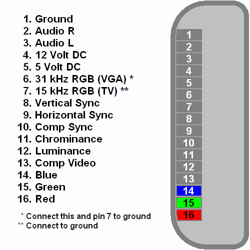

  20. lord_raymon
    lord_raymon Active Member
    May 18, 2012
    Sorry if this thread is old but I've been researching this problem ...
    If you have black screen it is because your TV does not like 12V on pin 8 of SCART, using 5V will run smoothly :)
    I have opened my cable connector and swapped the cable connected at pin 4 to pin 5, now it works in all my TVs.
