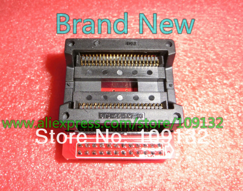

    i got japan VA0 ,3.3V flash chips and TL866+PSOP44 adapter. its possible to use 3.3V flash chips on 5V board?

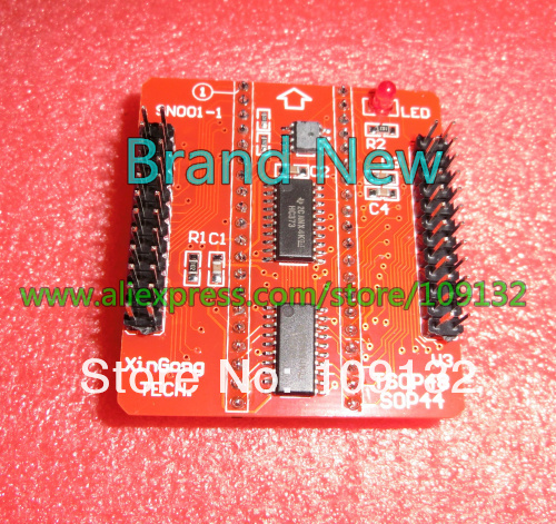

    Only the TSOP48 is supported in the software. I tried both adapters and the pinout rewiring trick and nothing works, just fails immediately when disabling Check ID. I’ve yet to see someone say it works so I wouldn’t waste your money. Piggyback install a socket apparently works ive read. Let me know if you figure something out!

    not a big deal at all) if you are tech sawy enough you can install linux,download https://github.com/vdudouyt/minipro ,add the correct chip in the the devices.h file,compile and have fun.
    UPD. minipro does not make difference between TSOP48 and SOP44 packages. there is package config parameter in device db just to display you a image related to adapter config. to flash MX29LV160TMC chips you must select MX29LV160T from the list and respectively MX29LV160B for MX29LV160BMC (T means top boot block and B means bottom boot block, MC stands for SOP44 package) technicaly there are only 2 chip ID's for MX29LV160 chips: "c422" for "TOP" boot block and 4922 for "BOTTOM" boot block. you allso need those adapters displayed on attached images.

    it seems you have some troubles related to A19, could be adapter issue.

    It's always said that though, I am using the exact same adapter you linked from AliExpress. I've searched far and wide and can't get it going, you're saying your exact adapter works?
    Not sure if my chips are counterfeit or something, they look real and have the MX logo. They are like $1.20 a piece I don't know why they would sell fakes but it is China I guess. The adapter I have read there are fakes, but in the listing he claims it's 100% real etc so I don't know.
    I'll try to reflow all the pins and see what happens, not sure what else can be done with it.
    Update: reflowed every pin on both pieces top and bottom, same pin issue.

    it could be just DOA non-working adapter, since TL866 products suffer from heavy piracy.

    Think it's worth the effort to resolder a new SOP44 adapter, it detects the actual TSOP48 adapter because if you don't have it plugged in then it will alert you. There's no logic on the SOP44 adapter board. Thanks for your help so far.
