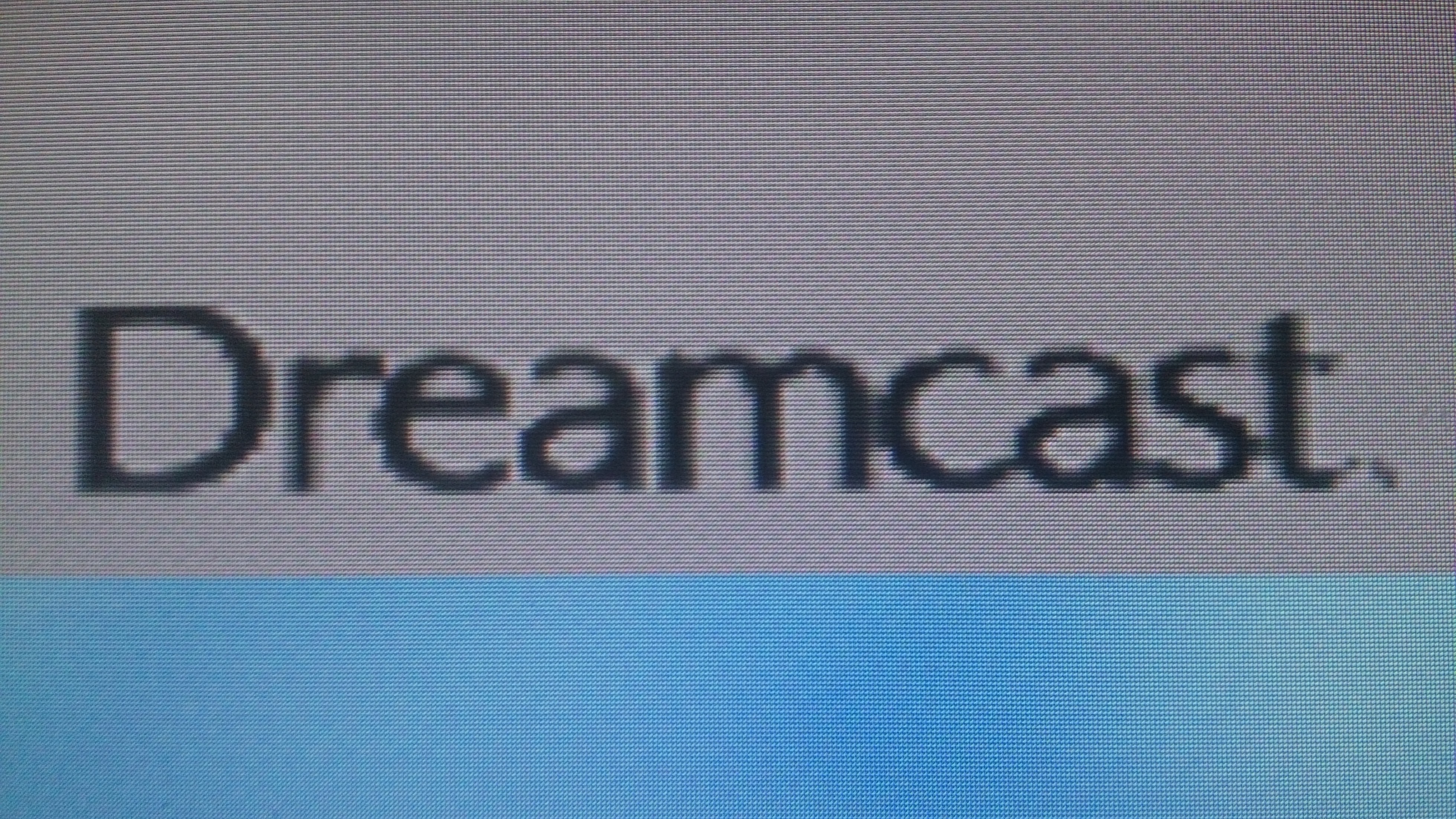

    The main reason I wanted to connect it to my Framemeister is because I have a strange mesh pattern over the whole screen, which sometimes looks a little wavey. DSC_0129.JPG
    For the record, I didn't mod this dreamcast myself and I haven't looked inside it yet (might do that later today), so I have no idea how good/bad the mod is.

    Is that picture with it hooked straight up to a normal VGA monitor? Because I don't think the Framemeister is going to fix that problem... sounds like an issue with the mod to be honest.

    It's connected to the VGA port on my LCD Monitor. I opened the console up yesterday to have a look... It's not exactly pretty.. but it all looked ok. Could it be the VGA cable?
