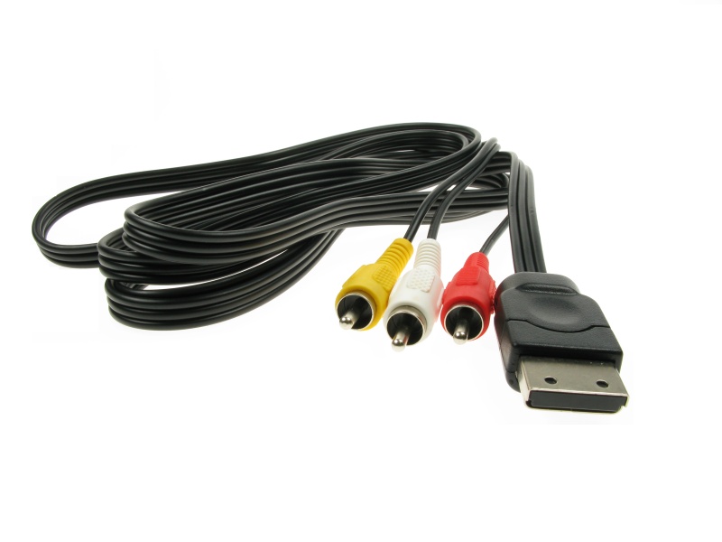

    I am using brand new standard AV/out cables that work on all other Dreamcasts fine. The AV out port on the Dreamcast looks fine, with all pins intact.

    What connection are you using for video?
  3. NateN34
    NateN34 Member
    May 25, 2012
    Just standard AV cables. These AV cables are brand new and work with all of my Dreamcasts just fine, so not sure if these could be an issue?

    Probably just needs some touch up work on a few solder joints. The A/V connector isn't likely to cause this sort of thing.
