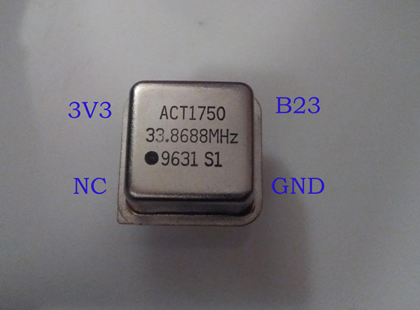

    After all this time I found some crystals. But it still doesn't work without the gdrom board.
    Is it ok how I connected the crystal?
