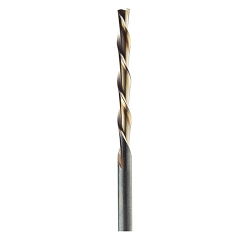

    For better control of cutting a groove. Rotozip ⅛" shank wood bit, with a cutting tip not the pilot point. Its a tall blade for the little Dremel collet bearings, be sure its snugged down straight. Plastic will melt during the cutting, just take it slow.
