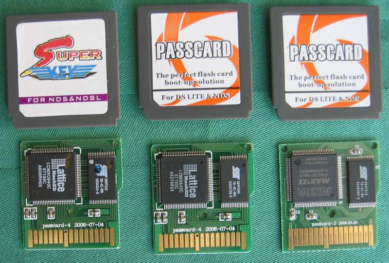

    They are glued together. You can open it. Try start on the top and then on sides with a sharp knife. The one thing about original cart shell is that they are made only for one side PCB. So if you want to have double side (components) then it won't fit.
    I would suggest to use shell from fake one or from Superkey/Passkey. I might be able to get you one or two for the start and if you want a small run then I might also be able to get it.
    On the other hand I would be interested in such a cart just for one game for my translation project.
    If you want some pictures let me know.

    I just remember that the Passcard/Superkey card have a 16 MB rom so I think that the cheapest and easier solution would be exchange the rom chip on one of this card.

    Same as two side components. The flash card won't fit in a regular shell as most of them have component directly under the sticker. Not to mentioned that the SD card is in the same level as the shell. Maybe, you would be able to move the slot a little inside, but that also involve good soldering skills.
