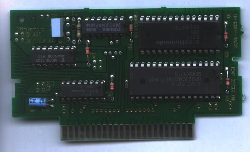

  9. overload
    overload Member
    Dec 21, 2012
    PilotWings (JP) has all the necessery chips (DSP1+74hcu04AP) and XTAL (7600A)
    Hope the info is useful.
    Just fitted all the components to my SuperEverdrive and it works perfectly.
    p.s.
    A hot air heatgun really helps with the removal of the DSP chip, all other components can be easily removed with a plunger type solder sucker but the DSP is pretty stubborn, it took about 7 minutes to remove the 74hcu04AP with the sucker and a little bit of prying with a screwdriver, for the DSP1 I used the heatgun and it came off in less than a minute (tried the sucker on it earlier and didn't have much luck), should have used the heatgun for removal of all the components, would have been alot quicker and easier.
    I wouldn't say the list is useless, a complete list would cut out alot of headache and guesswork.
