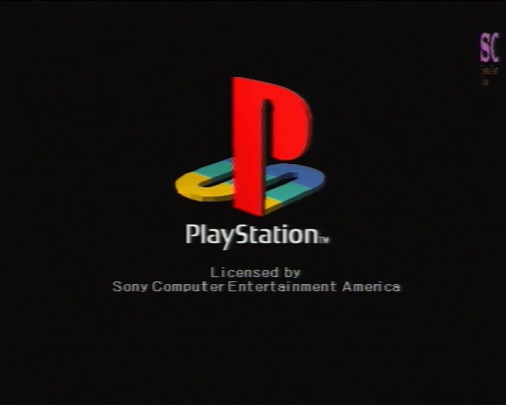

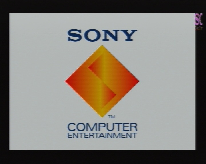

    If you look closely at the right side of the screen, there's some unusual rainbowy pixels. With a TV capture card I managed to get an uncropped image:
    The contents of this change depending on the image, it seems like part of the video RAM.
    Has somebody seen anything like this before? Is it likely a capacitor issue? The board looks clean with no visible leaking caps, but as always this doesn't mean they are ok.

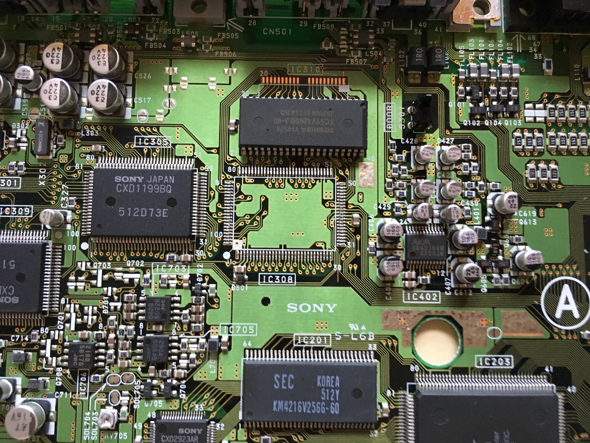

    I currently don't have another SCPH-100x but I will swap the SPU once I get my hands on one.

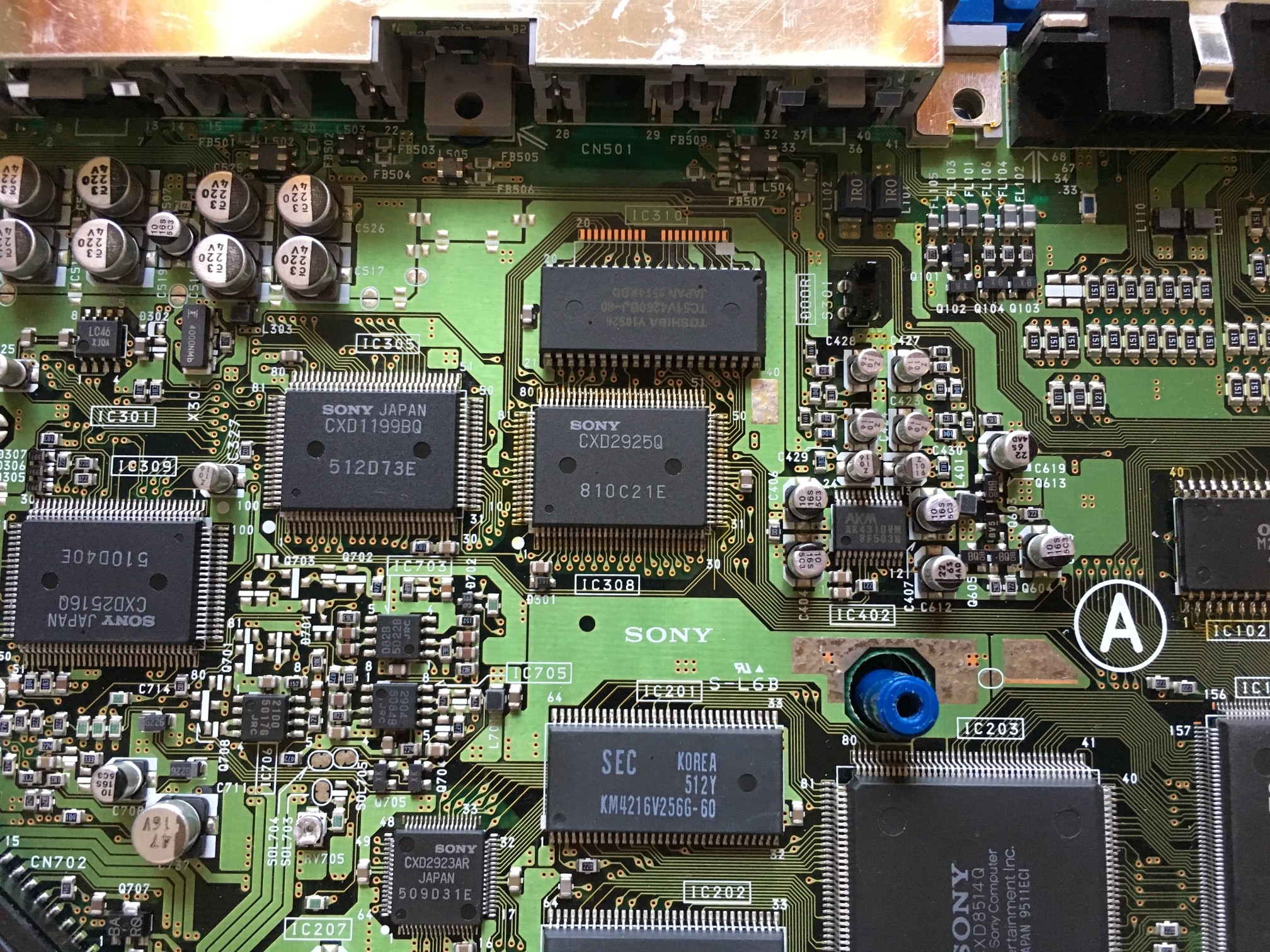

    I remembered that I still had a PSX with a broken disc drive somewhere, and it turned out to be a SCPH-5502 (PU-18) with a compatible SPU.
    Bit of a shame to use this one as a donor since it's in decent shape otherwise, but the DTL is more important right now and maybe I'll get another SPU from somewhere later.
    Out with the old
    In with the new
    ...aaand the audio works perfect again!
    Thanks Bad_Ad84 for pointing me in the right direction!
