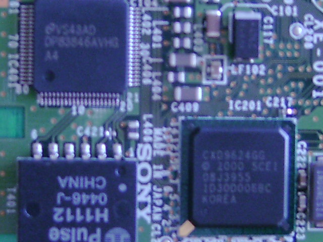

  4. ASSEMbler
    I have pics of the board if it will help.

    Maybe there are different versions of the cards and only some of them are fully PCMCIA-compliant? I don't know how general the PCMCIA interface of the 10k/18k is, so this could indeed make sense if the console were made with only the Sony cards in mind.
    It might, can you please post them?
    I would also be interested in how the PCMCIA subsystem actually works, especially which part of the IDE and ethernet (or modem) functionality is implemented by the card and by the mainboard. Does anybody have any information on this?

  11. l_oliveira
    l_oliveira Officer at Arms
    Nov 24, 2007
    3,879
    245
    Because my card only lasted me one week back in 2003 I had no option but open it. Turns out it has been pretty poorly assembled at the factory and several pins of the PCMCIA connector disconnected, causing the card to stop working.
    Since I fixed that fault it's been serving me beautifully.
    It's basically the same thing as an SSBUS (Expansion bay) network adapter using the same controller chip (CXD9624) even.
