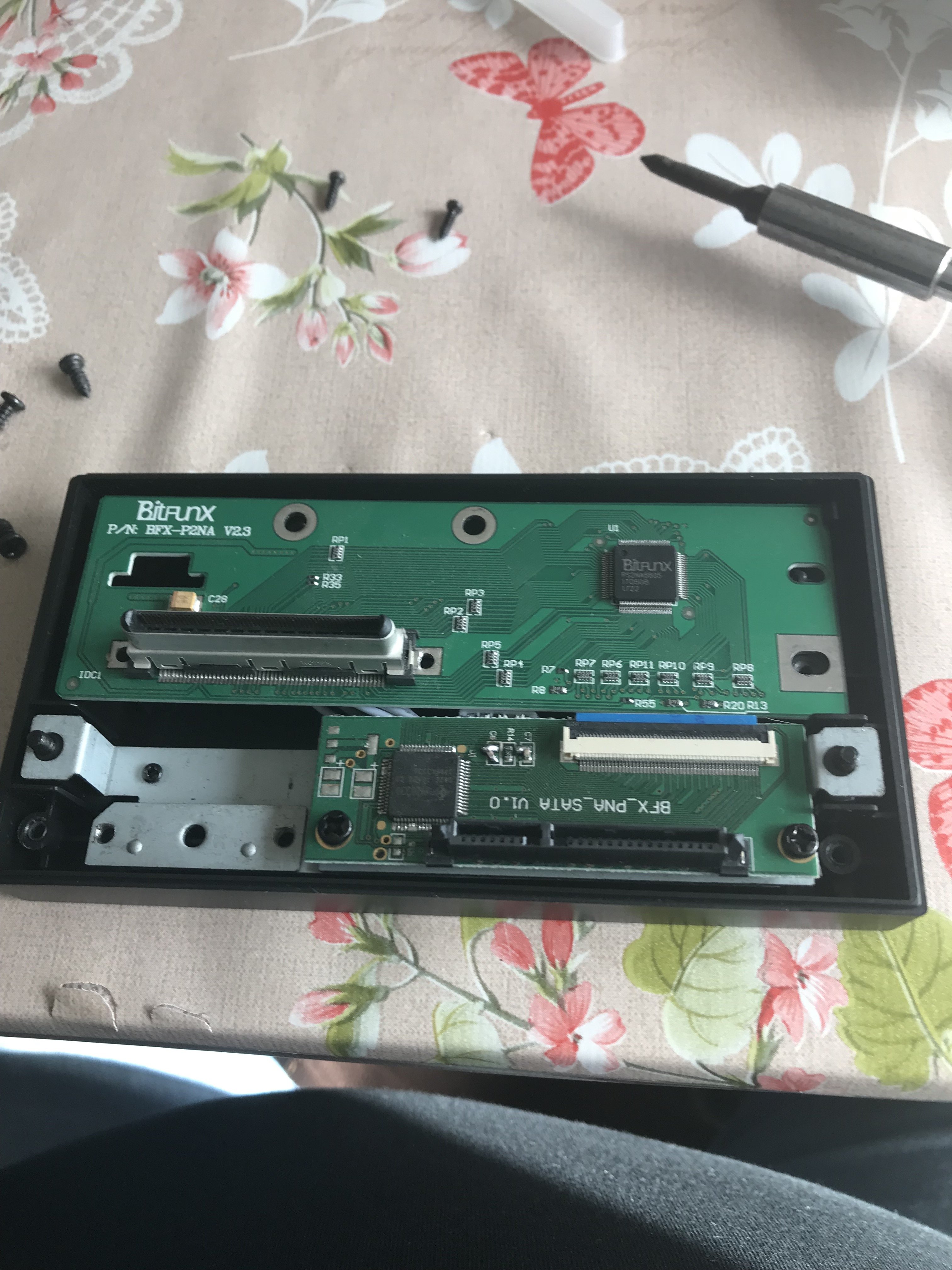

    I ordered a SATA Adapter from Ali express, and i will take this apart and put the sata part in my ide BBA.

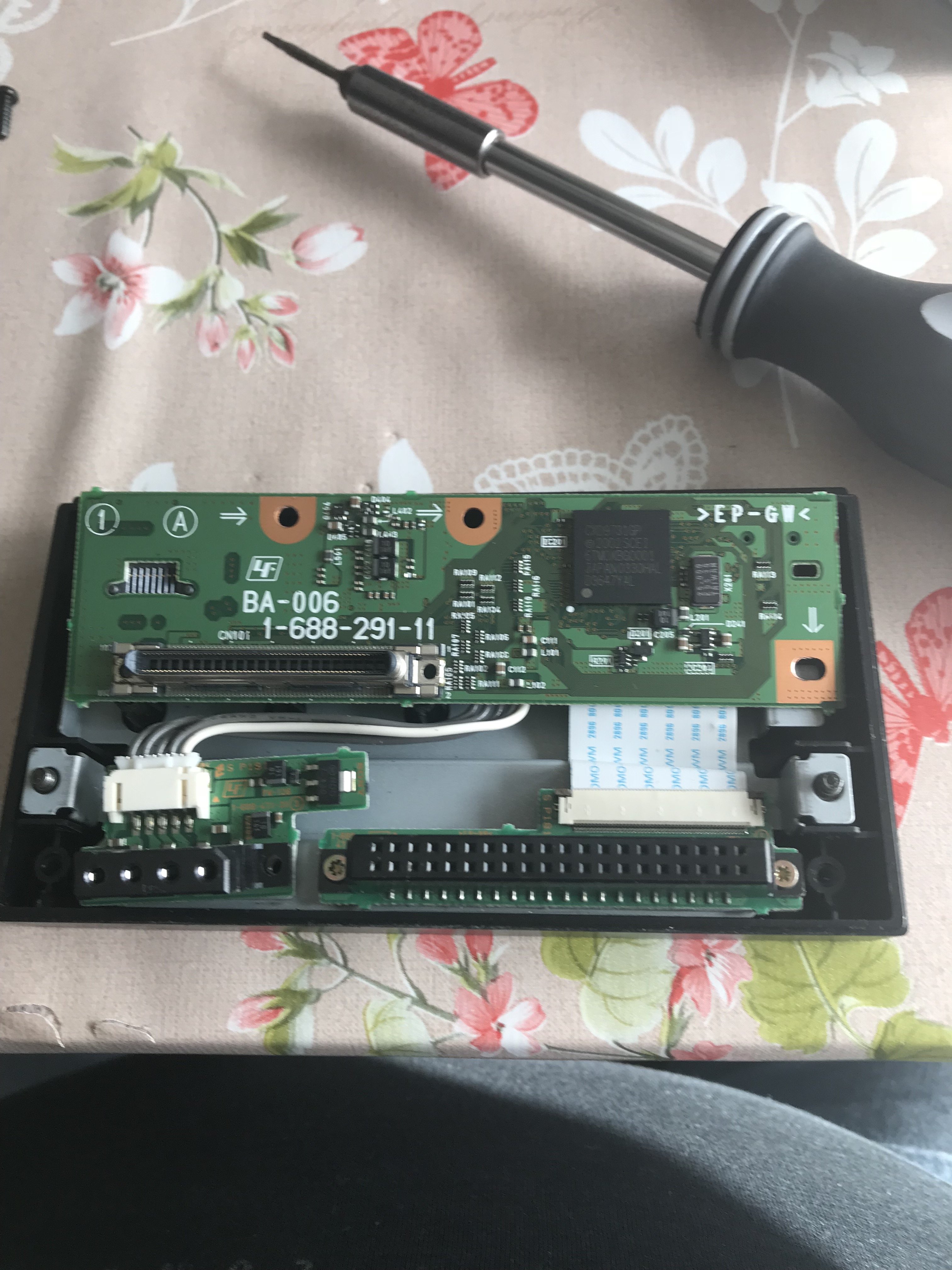

    Yes the hdd is the way to go, but I only have BBA with IDE, but no IDE HDD,
    I didn’t order a IDE to SATA, but a bitfunx SATA network adapter, I know the Ethernet port is not working on this, but I can take out the SATA part of the adapter and put it in the BBA with Ethernet I already have.

    Installing an IDE to SATA adaptor would be best. Those compatibles do not always work very well. At some point, some of them started malfunctioning after some updates were made to the design of the homebrew DEV9 and ATAD modules, but workarounds were added.
    Usually, they are made to interface with a SATA disk, so there is nothing for you to bring over.

    Okay I I got my "Game Star" SATA adapter in the mail.
    I took out the part with the SATA connector and swaped it with the IDE connector.
    In ulaunch I see the HDD I can format it, and I can connect to the network (lights go on on the port, and router sees the ps2)
    But for some reason in OPL I get a error "no network adapter found"
    sp193 have any idea ?
