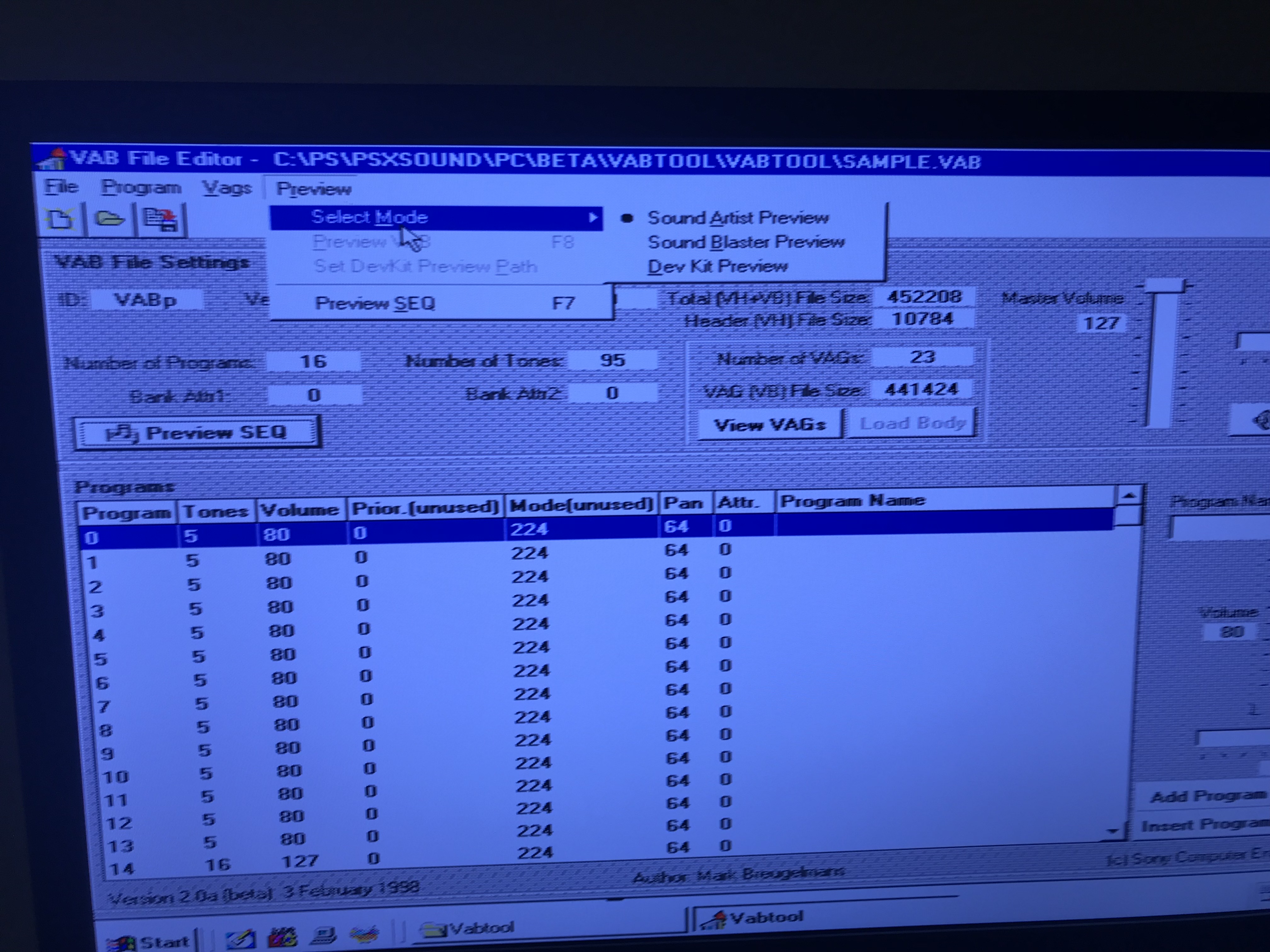

    I investigate on my dev pc the drivers and .inf files for Windows. It looks like the INF was not finished at all. I tryed different things installing the Artist tool with the INF that is pointing on a dll and a vxd file. But unlikely windows dont want the drivers and show the H800 as "Other device" in the device manager.
    When i compare the H800 inf with the h2500 inf there a missing sections.
    Is here someone with knowledge writing INF files and can tell something more whats missing ? Maybe we can restore or finishing the files to get the H800 working on Windows.
    I add the PSX Sound folder with the beta driver and my INF files.
    At the moment when i try to use the h800 (devkit) device link in the VAB tool i got an error linking to the h800.

    it work on win95 SE

    do you have different drivers? Can you share it please? I also have Win98SE.
