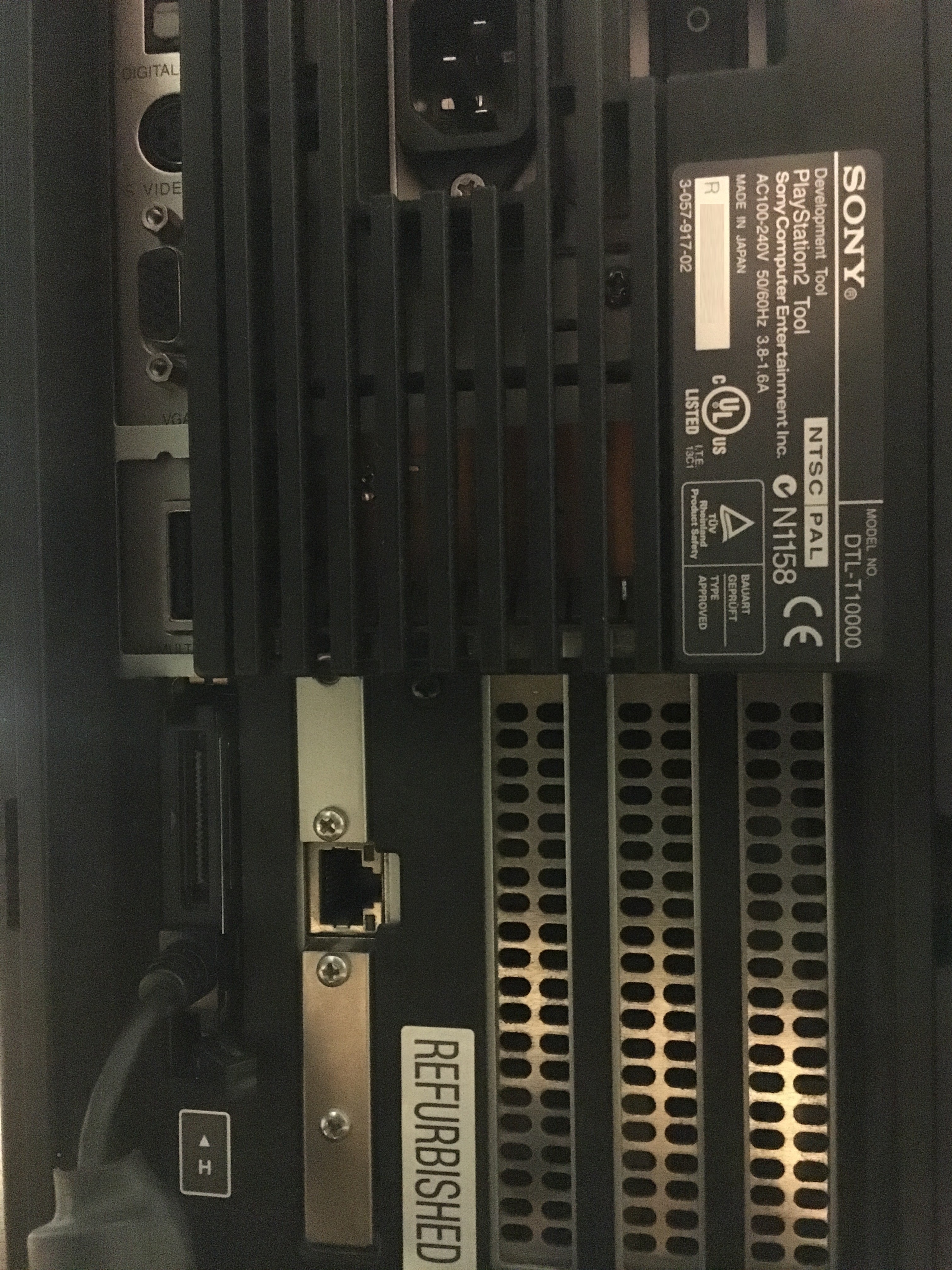

    I managed to get one of these units, before you say search the threads for posts like this, i know they exist but i didn't want to bump a year old thread and was wondering if new info has come to light since.
    So my basic question is a refurbished DTL-T10000 functionally the same as a DTL-T10000H?
    It has a network card with an Ethernet port and a PCMCIA? slot in another card the letter R that is NOT handwritten next to the S/N, it also has the label REFUBISHED on the back where the cards are at the bottom.
    EDIT: Also, the PCMCIA slot fits a DTL-H10010

    If you need an image to see what I'm getting at see the below photo:

    I cannot totally answer your questions because I have never used one of these older TOOLs.
    Its debugging functionality is exactly the same, but SCE described the H model as the one with support for the HDD unit.
    It is known to have a PC CARD slot, but... if it worked, then there would be no need for a H-model.
    Honestly, I am also curious to know what is different about it here. I don't know if you know how to do things with it, but I would load dev9.irx, just to see whether it'll locate the network adaptor.

    The thing that perplexes me is that H pointing at the PCMCIA slot so it's possible this thing was retrofitted with the additional hardware, however before i turn this beast on i want to image/clone it's HDDs in case they fail in the future.

    Looks like my unit does indeed look to be retrofitted.

    That is one possibility. IMO, it isn't impossible for T10Ks to actually have a functioning interface. They mentioned that the H-models have support for the HDD unit... but why only mention the HDD unit? So I think it is possible that the T10K units aren't compatible with their HDD DNAS.
