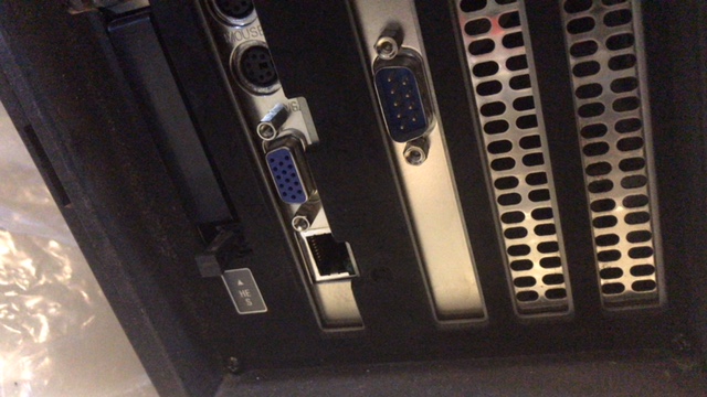

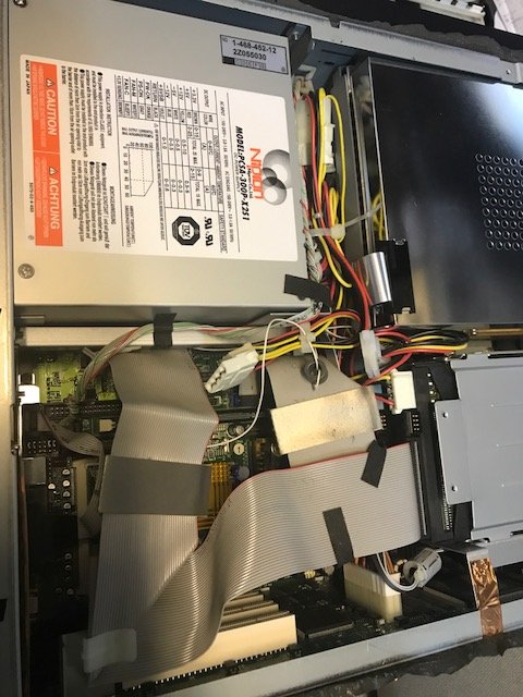

    there is my another DTL-T10000HJ
    this is first to see they use seagate HDD for internal use
    and....PCMCIA card slot label is not "H" is..... HE S
    today still clean up, may be i will week end power on it let see what different :)

    It's the Japanese version - it's region locked if I am not mistaken.
    However you do have the newer PC card with 566MHz Pentium 3 Celeron instead of 233MMX.

    My set has Seagate HDDs too.

    right, i dump the hdd, is same as T10000H , but why PC CARD slot label it HE S ? HDD EMU Software ?

    One thing that comes to mind is if the "HE S" is related to a different SPEED chip revision... but because that marking is on the slot rather than on a PCMCIA card, it isn't that.
    The next possibility is a more complete or incomplete support of PCMCIA cards and/or the SPEED-chip PCMCIA card. Best check the Dev9C (SSBUS Buffer) chip revision and compare it to that of other TOOLs to know if that is related to the revision.
    "HE S" ?= "HDD and Ethernet Supported" (or "HDD and Ethernet SPEED chip to be inserted" (given the arrow above "HE S")) ... but the Dev9C shouldn't be related to what SPEED chip can be used with the TOOL.
    Because the AIF is on the same PCB, it may be a good idea to check its revision as well, although it is unlikely to be related to it. The AIF is known to sort of a lack DMA for the HDD which doesn't quite make sense, so this might be a later or earlier version that is more/less complete is some other way.
    I doubt there is some software that emulates the HDD or related to HDD and emulation. This shouldn't be related to the SN Systems DVD Emulator.
    There is a feature to emulate the CDVD DSP through the ExpansionBay connector on some PS2 models (SCPH-30000 for example), but I don't know whether (doubt) that this feature was present on early models with the PCMCIA interface instead the ExpansionBay connector, because it uses dedicated "pins" on the ExpansionBay connector. Still it is not impossible that the "HE S" signifies some difference in the PCMCIA signals.
    I am not familiar enough with the PCMCIA standard to say whether this marking may simply signify the "class" of supported PCMCIA devices or something like that.
