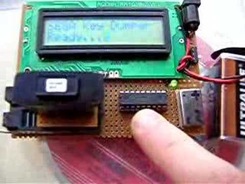

    It's safe to assume when the DES key is already available, the GD-ROM image is as well. However if you ran across a undumped (or BETA) release on GD-ROM, you'll also need to dump the key yourself.
    All the NAOMI GD-ROMs that are out there for play on emulator (or netboot) have most likely been dumped using a Dreamcast, and the key with the key dumper.
