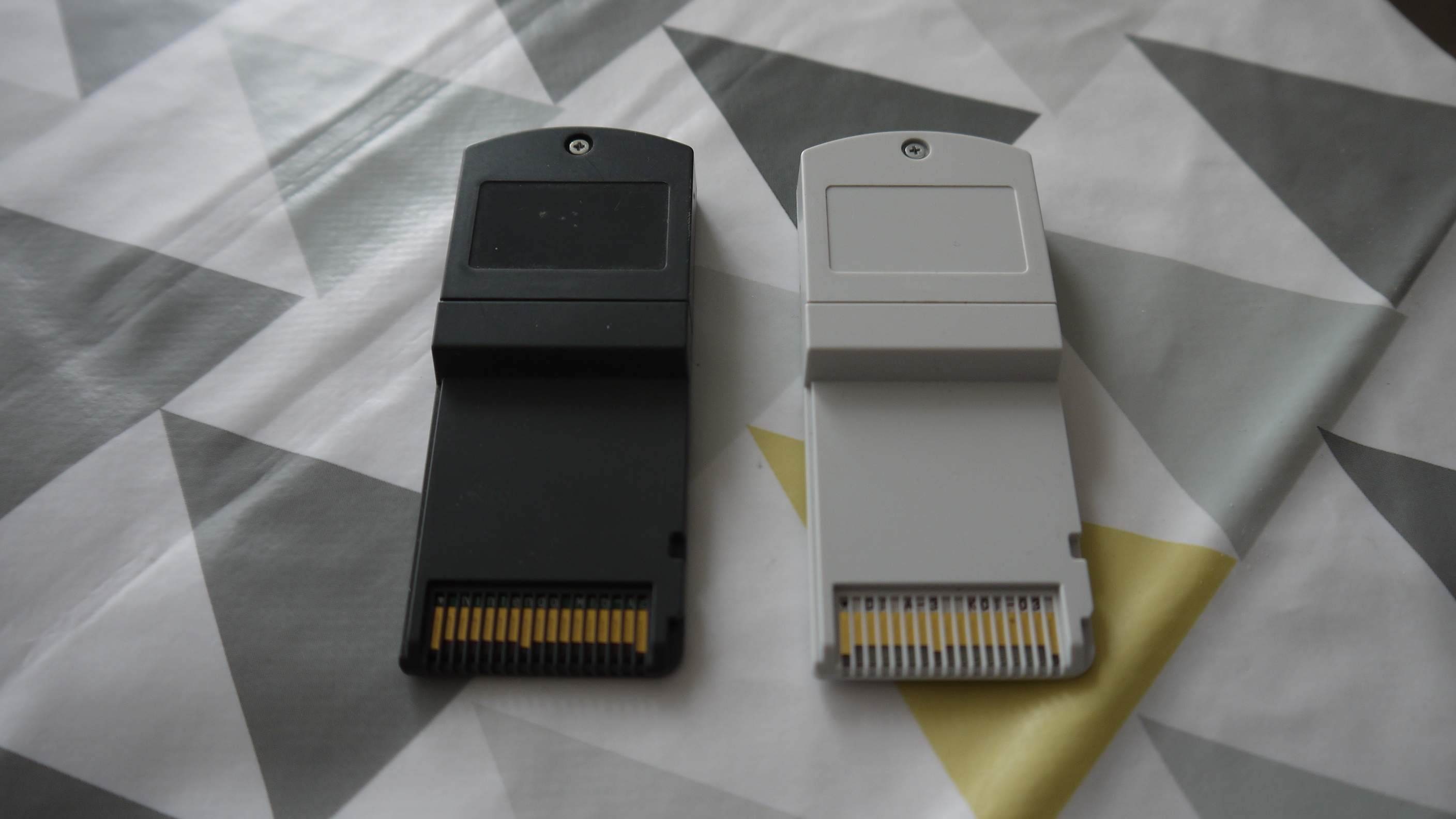

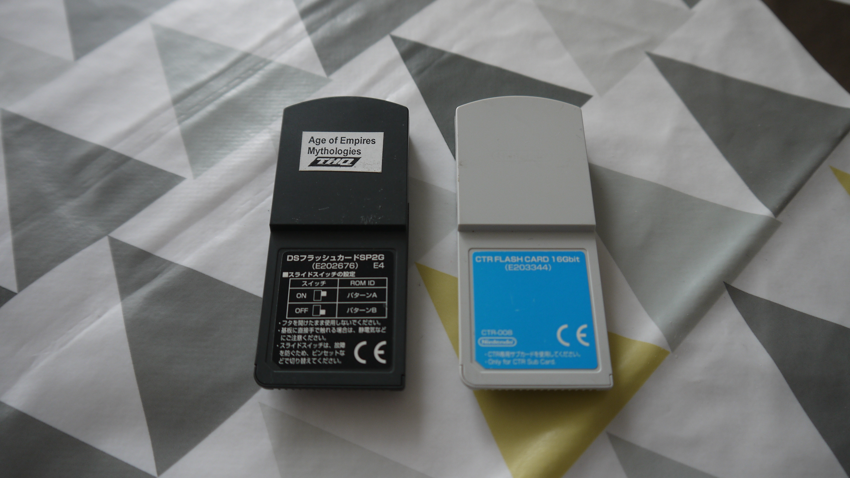

    Hello all,
    Since yet, I haven't noticed that DS dev carts and 3DS dev carts have the same shape (see the pictures I took below). Then I wonder if someone has ever tried to dump a 3DS cart using the same way we do it for DS carts (with WoodDumper for example).
    DS and 3DS probably not work the same way. Voltage of frequency may be different. Has anyone information on this ? Or anyone knows if someone has ever tried to dump a 3DS game using a DS ?
    Thanks you :)
