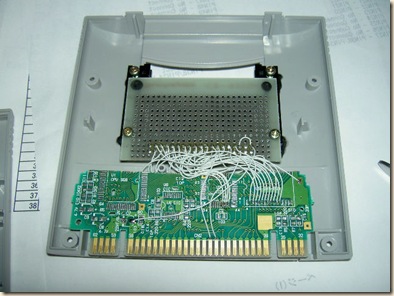

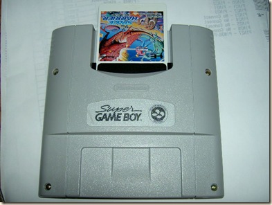

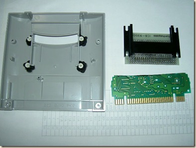

    I guess I wouldn't mind dumping what I have, but I don't have anywhere close to a full set, let alone rare titles or not-for-sale ones (Though I am trying to grow it). Maybe I have access to about 50-60 games HuCard games? Another problem is that I have no Electronics skills, so I'd have to get someone to make a dumper for me. The easiest route would probably be to buy a Retrode, Super Gameboy, dead or beat up PCE and send the SGB and PCE out for modding (sack the cartridge connector and shove it into the super gameboy with the correct pinouts).
  12. Calpis
    Calpis Champion of the Forum
    5,906
    It would probably be better to use another cart than SGB, I think everything in the SGB is surface mount so it could pose a little bit of a problem for wiring. If you sacrifice a RF/CoreGrafx PCE for the connector (which is connected by a ribbon) the ribbon can be soldered directly to SNES mask ROM through holes which is probably the most sturdy way to do it apart from a PCB. I'd use a LoROM game, and file a space for the ribbon (with connector) to hang out.

    Hrm... I see some Japanese user has already done the SGB method. I take it the PCB was changed out with another sack game. Seems like it works ok and it's visually pretty clean and neat.
