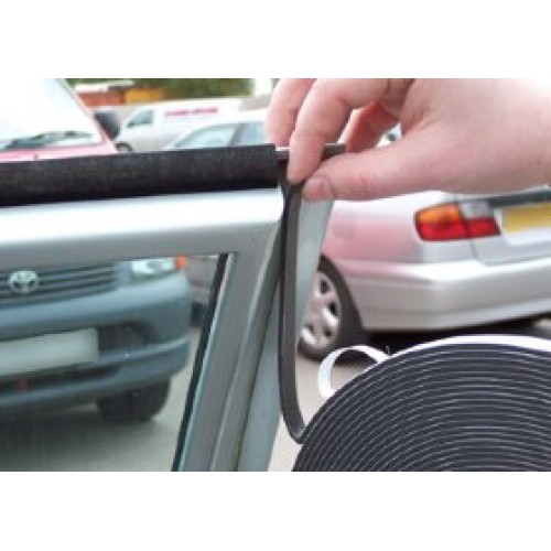

    You may use some grip tape to the fan so it won't move, but it's not necessary
    http://www.soundproofing-direct.co....pe/acoustaseal3_large_784_general-500x500.jpg
