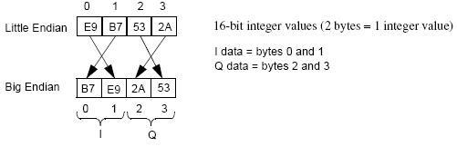

    1,308
    Thats not byte swapping for endianness (reversing the order the 2 bytes), thats selectively pin swapping to make the rom pinout better, as you said.
    This is byte swapping:
    To byte swap with wiring - you would need to wire D0-7 to D8-15 and D8-15 to D0-7.
    You are confusing 2 things.
