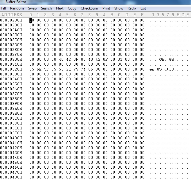

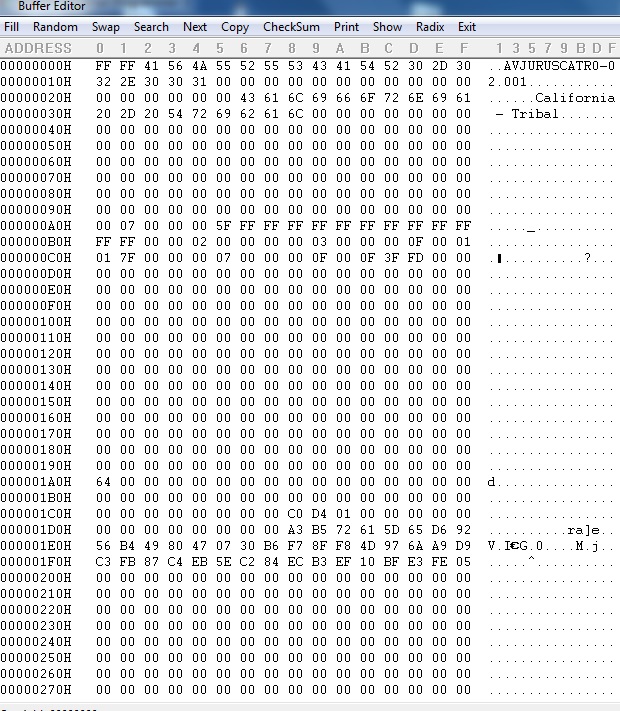

    Hi,
    I have dumped the 24C16 eprom to my pc with VP-390 programmer.
    Here is the Hex Result of the file dumped.
    Where can i change the Hex file to have nothing or F instead of dollar symbol or Euro you think?
    How to program on same eprom after change on hex file? is it possible on 24C16 eprom?
    like erase and program new file on device.

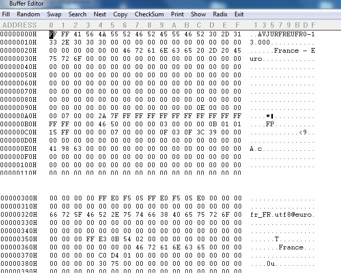

    Here is my original JURIDICTION Chip with EURO Symbol:
    If you compare what part in hex i need to change to have F instead of EURO Symbol?
    Or to have nothing after numbers...
