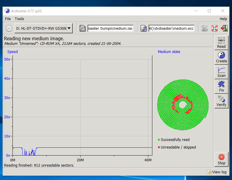

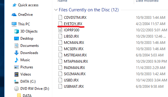

    Yeah. I'll try DVDisaster on this disc and see what happens. Since the seller was able to take a screenshot of the files I suppose it's not long since it did run on a PC... It'd be too bullshit if it dropped dead on it's two week travel to Norway....

    This is the prognosis after running DVDisaster's "Read" function straight with default setting.

    Not bad at all actually. Depends on what data is damaged. Try that iso on an emulator.

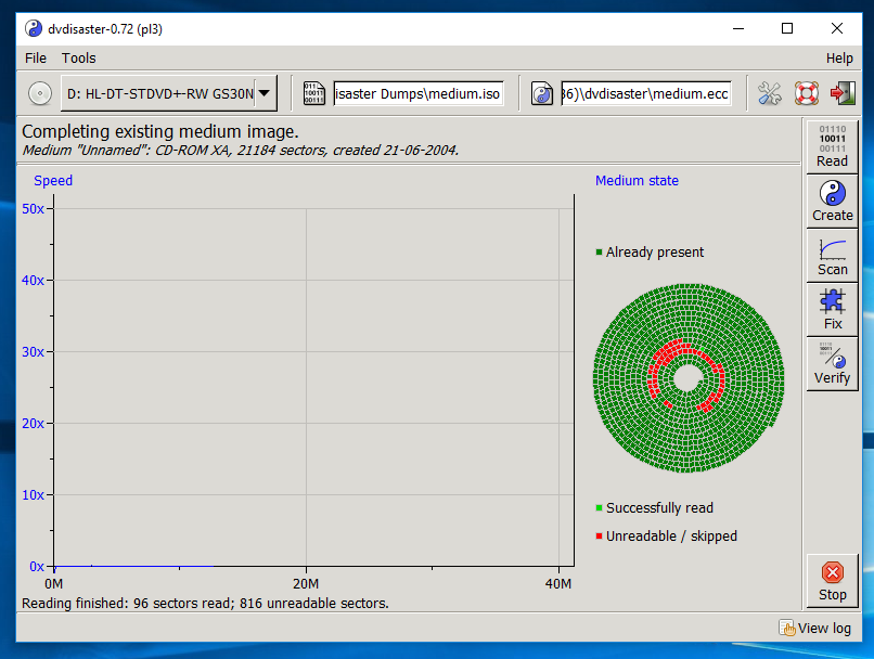

    Second read got a bit better too.

    With about 800 bad sectors, that is 1.56MB of data lost from the inner part of the disc, which is quite a lot. The game may not be functional because of that.
    If booting the game does not work and you're interested in finding out what it is, you may be better off opening the SLES file with a hex editor and scrolling through it to find strings that may give away the identity of the game.
    (personally, I would just open up the file in a hex editor since 1.56MB on the inner track might already have eaten up part of the executable).

    You can't get a complete dump since part of the data area has been destroyed (you can even see through it). So you may want to save all your attempts, just in case the disc only gets worse in condition as you work on it.
