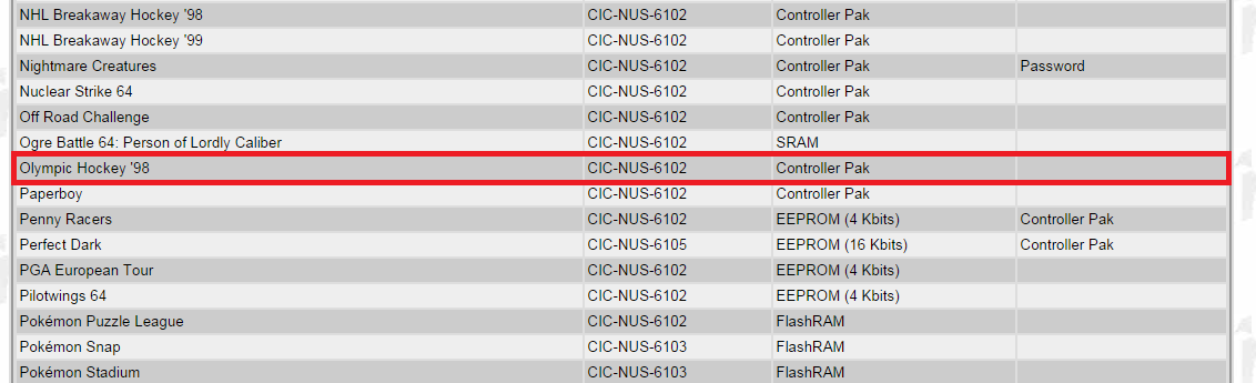

    Nah, shouldn't really make a difference as long as it's a 6102 CIC. Now, if you were using a copier like e.g. a Z64, things would be different - both the cart's save type and CIC would matter. Maybe that's where that rumor came from.
    edit: Game/CIC list for reference

    The Game I am using, is this: Olympic Hockey 98.
    According to the CIC list: It is a 6102.
    I also opened up the cartridge at one point, and can confirm, that this is true.
