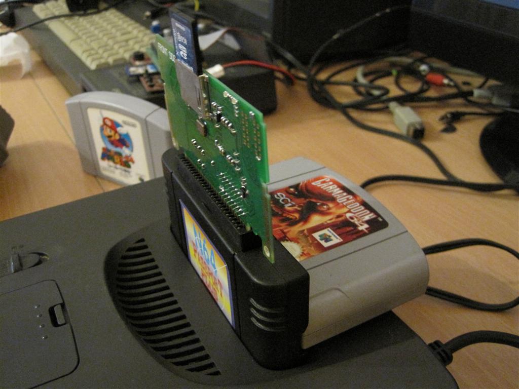

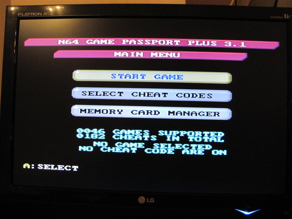

    I can confirm that my NTSC CIC Everdrive 64 v1 works on a PAL console with PassPort III Plus.

  7. fraktmp
    fraktmp Member
    May 14, 2011
    Well the photos are 14 months old, so I'm not really sure if I tried using cheats. I think I did, but I could be wrong.
    The next time I set it up I'll give it a try, but it'll probably be a while...

    Yes! I can confirm this. I now have my RGB modded NTSC console and can confirm this works great! It is the method I'm currently using with my own PAL Everdrive 64 :biggrin-new:
    Unfortunately, you can only boot into the Everdrive OS if selecting to 'load game without code' from the Passport Plus III menu so no cheats I'm afraid.
