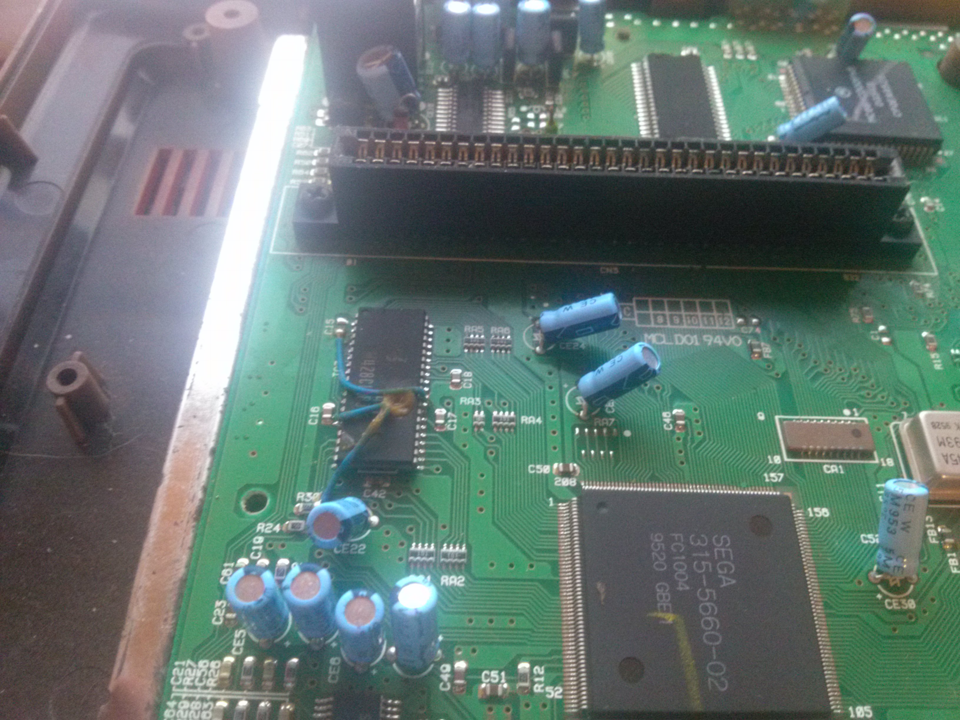

  14. yelever
    yelever Member
    Aug 4, 2012
    Here's the motherboard. As you can see to the left there are some wires on one of the chips. Not sure if this is a mod
  15. lnx64
    lnx64 Robust Member
    Jan 6, 2012
    202
    That looks more like an engineering change order, than a mod.
