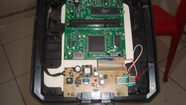

    I just tried with another SD card (this time a real SD, not a adapter), a 256MB FAT formatted with 32KB sectorsized, and the problem still persists. So I think this possibility is discarded. One thing I forgot to mention is that my TecToy system is a modified version of original Genesis console, where are 30 games that already comes in the console, and the motherboard is very different from the original: http://1.bp.blogspot.com/-o7sij0XXVS0/TyiQWtO9rXI/AAAAAAAABUc/nZIXxB4MsXY/s640/DSC03950.JPG

    Well, I just tried another console and........ *drum roll* IT WORKS! Just tested with Sonic & Knuckles and Joe & Mac and the rom was loaded sucessfully. I used a model 1 Tectoy (based on Genesis M1). So MAYBE the Everdrive MD is not compatible with Super Mega Drive 3 w/ 30 games from Tectoy, or the console itself was damaged. Thanks for anyone who tried to help me and especially thanks Krikzz!
  15. Johnny
    Will post in portuguese:
    claytonpoitevin, verifica a versão do seu MegaDrive. Os únicos com placas originais são os Mega Drive e Mega Drive II (design original) e o Mega Drive III (design menor). Qualquer versão com nome Mega Drive 3 e jogos na memória e coisas do tipo já são placas da Tectoy, com modificações em relação ao projeto original. Provavelmente esse console que você tem não aceita Sega CD ou 32X. Provavelmente essa placa da Tectoy tem
    Aqui você pode verificar a versão do seu: http://www.sega-brasil.com.br/Tectoy/index.php?title=Mega_Drive
    In English: To sum things up, his MegaDrive is probably one of the later versions, called Mega Drive 3 instead of Mega Drive III. That's when Tectoy started modifiying the board to add games on internal memory, but also killing Sega CD and 32X support. I guess this modified board doesn't like / work with the Everdrive. To be safe, the good Tectoy models are the Mega Drive and Mega Drive II (original design) and the Mega Drive III (smaller design) sold up to 1996. After that, sadly, Tectoy decided to lower their quality standards.
