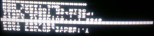

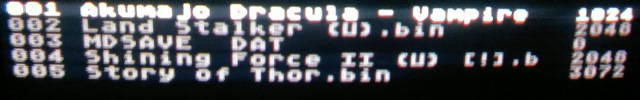

    I have a problem when i insert the SDCart in everdrivemd,sometimes it shows me the games that i have in and when i press to go back in the starting menu and then enter again,the font can't be recognized for some reason and i cannot flash anything.
    Sometimes it shows me only the 2 of 4 games i have in the SDCart.

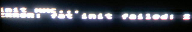

    I turn off my console and turn on back again,then i try to choose a game and it shows that the SDCart is not molded while i have already format it through the everdrivemd.

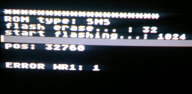

    There are times that when i am able to see the games and try to flash some of them shows ERRORWR1:2 or ERRORWR1:1.
    EDIT: My Firmware is v13 And the OS v23 REV CART 2.4 13.01.11

    turn on genny3 mode option, and reformat your sd card on PC. try another sd card if it will not help

    You formated the SD from Everdrive or PC?
    Format your SD card from Everdrive Menu, OS23 needs FAT16 and since Windows 98, by default, Windows format removable media devices in FAT32

    OK I turn on the genny 3 option and reformat my sd card on my pc FAT16 and it works but when i turn off the genny 3 and goes to game menu it dosen't show me games.
    Is that normal?

    just keep genny 3 mode enabled. you system generate unstable clock strobe, so cart use internal clock generator in genny3 mode
