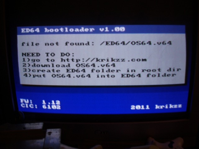

    Just received my ED64. I installed a CIC7101 from a PAL cart and have been trying to test the card.
    Without a SD card installed I get the following. See picture.
    I create the ED64 folder and copy over the OS64.v64 file from Krikzz's site and I get nothing. Just a blank screen.
    I have tried 4 different SD cards. 2 x 16GB, 1 x 8GB and 1 x 4GB
    I have tried os's 1.02, 1.11 and 1.12 and still the same results.
    Its strange as the ED64 bootloader screen actually says FW 1.12 and CIC: 6102 when I have installed a 7101CIC Is this normal?
    Any advise on this one guys?

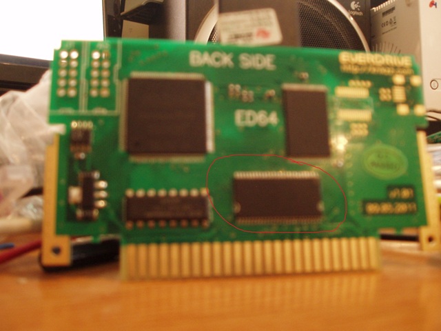

    Another thing I noticed is one of the chips is getting incredibly hot. I think its a memory chip
    See the chip circled in red

    It`s an SDRAM chip used for ROM game storage, I think

  7. KRIKzz
    KRIKzz Well Known Member
    Apr 5, 2010
    1,672
    SDRAM chip should not be hot. bootloader loads OS code into SDRAM, but looks like something wrong with sdr chip on yours board and OS can not be loaded.
    sad to say, but probably you should send cart to me
