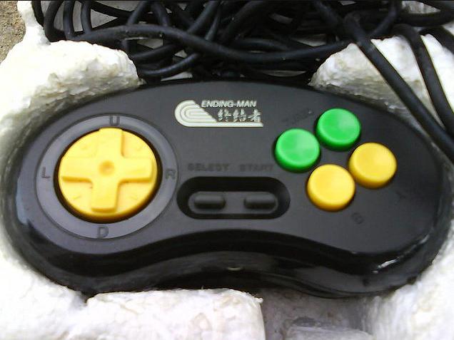

    I found some strange famiclone controller in my house: it has a 3.5mm jack on the back.
    The photos of the board:
    http://imageshack.us/g/155/imgp2876y.jpg/
    I have the board and the case without buttons (nothing special, some genesis clone controller with a hole for the jack).
    Some comic thing: the name of the console (written on the controller case) was
    "STAR GAME CONSOLLE". Yeah, they mispelled console xD
    It has a Micro Genius famiclone port.
    Do you know for what reason there is a 3.5mm port on it?

    Some Zipper gamepads had this feature: There was a sound-jack on the joypad to get the game music with ear-phones. The controller plug had a chinch plug for the red a/v-jack on the side of the NES.

    Some Micro Genius clones (and probably others) actually output the game audio from the controller port and have a headphone jack on the controller, I guess this is for something like that.

    I know EXACTLY what that is...
    This is an ENDING MAN 2 or a Terminator 2 Famiclone controller board. A super cheap single chip mostly PAL famiclone found everywhere in Asia. The early models had a headphone jack built in to make them look a little more complex. Later verions had that jack removed to cut down costs even further or due to lack of use. I have seen some models with only the metallic ring part of the jack but with no actual connector on the board. :banghead: Those clone masters will do anything to make a really cheap product even cheaper. !
    Here I a pic of one, there is an endless list of versions of this thing.
